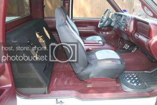

I've got a KICKER 2500 amp, a sepret Optima Batt. just for the my system, a ported custom encloser thats tuned & has a perfect cu.ft. volume, 0 gound wire, 4 amg wire, etc. etc - Now all I need to do is to decide what brand and model of Subs to buy!
As you can see, My encloser is built for 3 15's:
My dilemma is that I can’t decide between three AQSDC2.5 15's, or three DD2500 15's. I know that the DD's will kick the hell out of the AQ's, but their twice as expensive... (AQ's-$450 DD's-$950) When I', just listening to my system by myself, I will surly have my subs (no matter which ones I get) at the same level of volume. But with the DD's, I’d be able to really blow things up when I wanted to...
So what do you think, is it worth $500 for the DD's, or will the AQ's be able to satisfy my quench for ear drum destruction well enough??? Just tell me what you would do.

Here is all you need to know about my box and its perfection,, (i hope)
61" LENGTH
19" HIGHT
23" HIGHT (SLANT)
7.5" WIDTH (TOP)
21.5" WIDTH (BOTTOM)
24" PORT LENGTH
4.5" PORT HIGHT
the exact cu. feet is 9.7ft cubed
The tuning fq. Is 33hz-34hz
wich is perfect for 3 15"s!

box dose look to small for 3 15 i have 2 hdc315 they have 11.5 cubic net what is your ports tuned to the hdc315 like 40 hz mine sounds great also have mine on a AQ 2200d amp great amp run it on a 1/4 ohm load for burps would not recommend doing this very often though it will cook your subs
10 cubic feet for 3 15" is very small.
from AQ website
"and 15-inch subs work in 4.5cuft." you have a perfect box for 2 15", maybe you can baffle off the center cuout?
Or find subs that want 3 cubic feet ported for 15"
like a type Arghhhh! ported box volume: 1.5-3.0 cu. ft. for the 15"
AQ and they will work in that box with the right power. It is on the small side around 3.3 cubes a sub but it will work as long as they have good power. But I would build it up higher and get it to 12 cubes internal. But definately go with the AQ's
