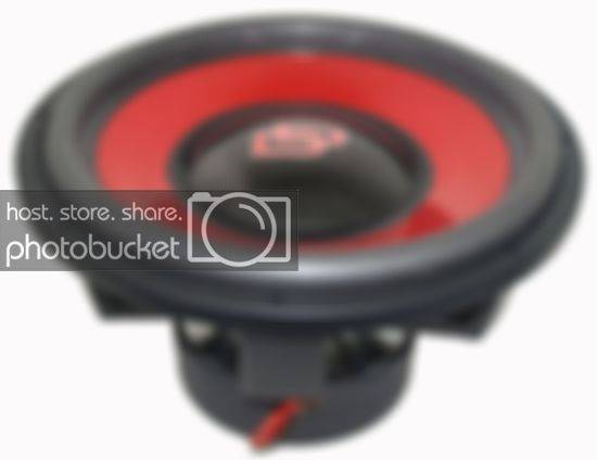

dd 9518 red composite cone carbone fiber dust cap
braggpawn
;what air space could i get away with you think. I might be purchasing one in the next couple months for my eclipse;)
shes sexy
im not just being wishy washy either. im about 90 percent depending on the space
DD says 4.5 - 6 cubes for an 18 ported, but that may be a little small. I would say around 6.5 net with around 100 sq in port. That'll be 9 cubes gross. Can you fit 9 cubes in a Eclipse?
