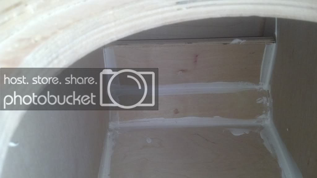

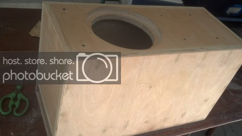

Coming from where im from. No fancy meters. No Distortion Detectors. No clamps . Just a decent set of ears a good Bone® for music and slamming bass. No burps no buckets and no bias. Single 8's boxes ported tuned to manufactures specifications.
Amp• Sundown Audio SAX1200d.
Played sa8v2 for about 2 months. Played extremely well.
Hooked up the DD2508sc and it blew that sa8v2 out the water hands down. As far as full musical range goes.

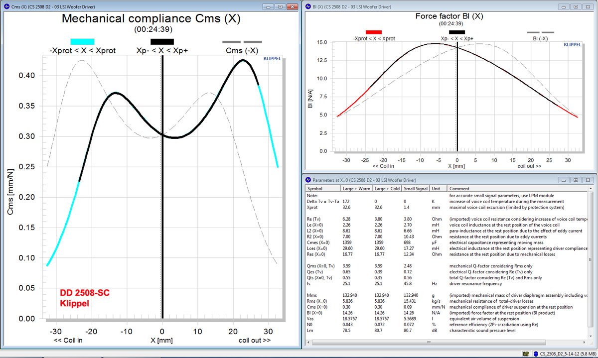

I have a pair of 2508SC here and I had them Klippel tested; they have some very odd characteristics.
The high level of distortion may be preferred by some.

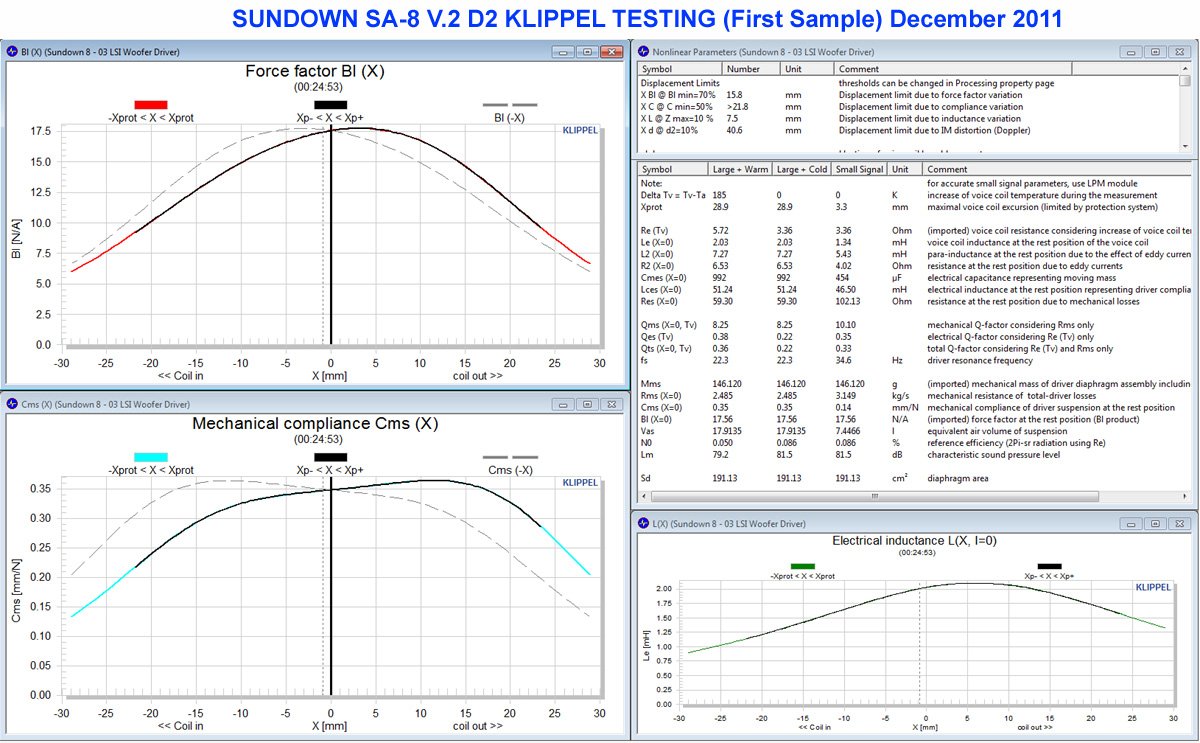

Compared to SA-8 v.2 which is very linear :
The very unusual CMS curve would lead to more low-end output at higher excursion levels as Fs will actually drop from at-rest over stroke in both directions; but it is simply from non-linearities (aka: distortion).
So in terms of someone preferring one or the other that can vary quite a bit.
Some people think the louder the sub is the better it is, others go by how clean it sounds and some go by both. Your statement is a personal opinion which you are entitled to but if you really want to make a valid point there should be a basis/reasoning to back up your claim otherwise its useless.
I personally would choose the sa8v2 because of the already mentioned more linear response curve, very controlled high power handling capabilities, build quality and price (a stamped steel basket on the dd2508 with its high price.....i mean come on)
Theres an obvious reason why the sa8s are one of the most popular 8" woofers around right now
