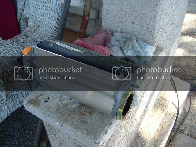

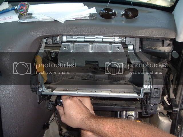

Not sure about your specific car but when we took the caddy apart... you can do it by just removing entire jockey-box , air bag (unhook negative terminal!) and airbag frame, and the vent assembly,
this is the Pass. Airbag:

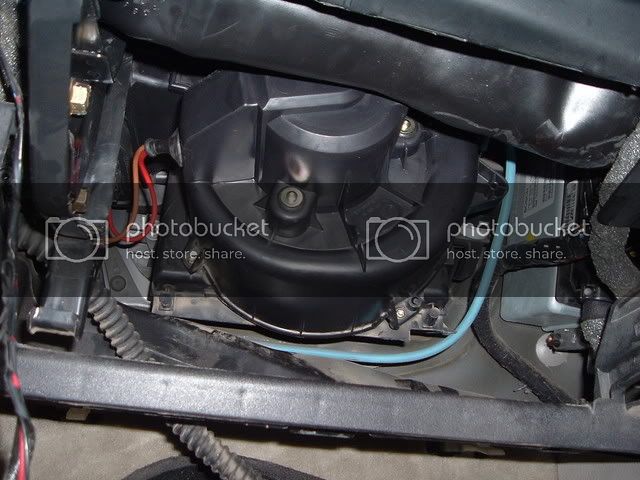

then you find this.
