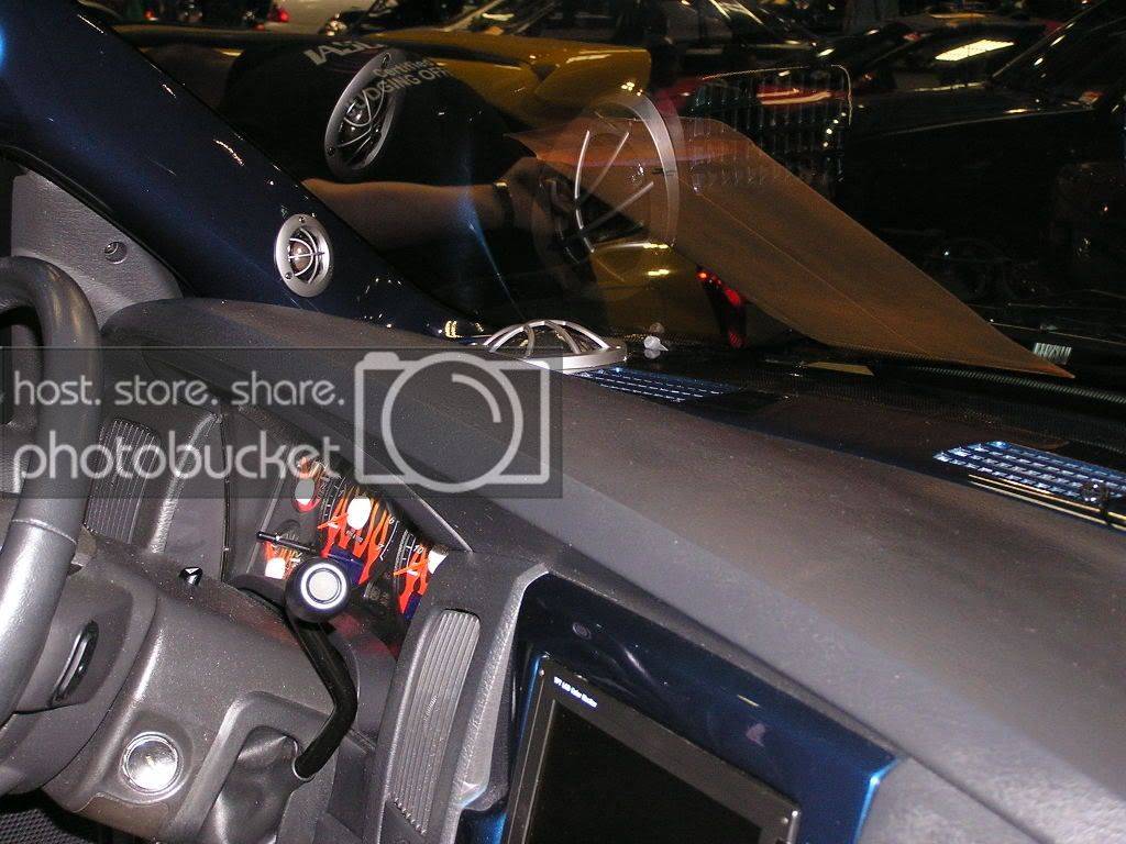

the center image...yes....very little if any music from the far right of the dash to about 11 o'clock...tonaly they are the best sounding dls setups aside from steve's civic that I have heard...I normaly hate dls...depth was incredible..way past the cowl..possibly center of the hood...I have pics of Jorge's truck, but not Steve's
