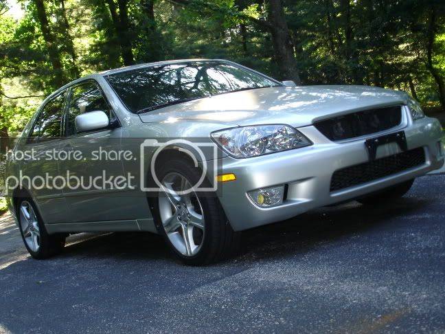

Yep, first time for me. The fuse was in the trunk b/c I ran out of time on my install. I did everything in one day so at the end of the night at 12 am I just said f*** it and zip tied it to some foam board I had used as a template to mount the amp.
Pics
Silver 02 manual IS300
Eclipse 8445
PPI 600.4
Focal 165V1
And thats it.......for now //content.invisioncic.com/y282845/emoticons/naughty.gif.94359f346c0f1259df8038d60b41863e.gif
