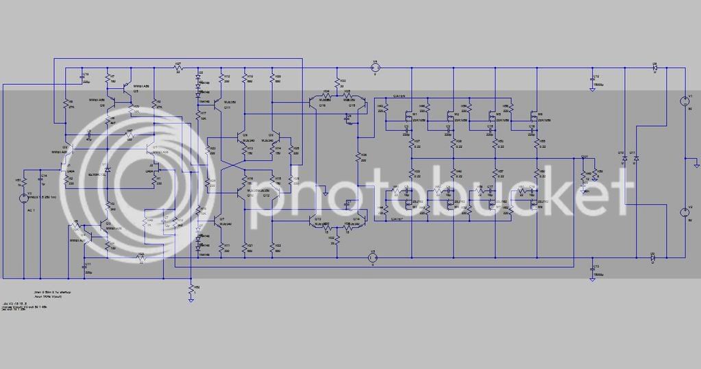

Mostly just tweaking, changing out FETS, and adjusting various things... I found the basic design but have been beefing it up. Doubt I'll ever built it but still I've learned from it.
build or it didn't happen.
I might...
I like the fact that it only pulls 1.3 Amps through the MOS-FETS at 200 W 8Ohm
It would be limited by the power supply, but I would say that with 80 Volts +- on the rails it could easily do 400 Watts @ 8 Ohms with less than 2 amps per FET. Last night playing with it it was doing 1200 Watts @ 2 ohms easy.
I am going to tweak the front end of the amplifier tonight. Try to make it more OPAMP friendly and take out some of the bipolar transistors for simplicity. I think it would be fine with a good robust OPAMP since the input to the MOS-FETS is less than 20 uA at full power.

that's a lot of resistors & diodes!
You forgot the most important part...
The MOS-FETs... //content.invisioncic.com/y282845/emoticons/wink.gif.608e3ea05f1a9f98611af0861652f8fb.gif
