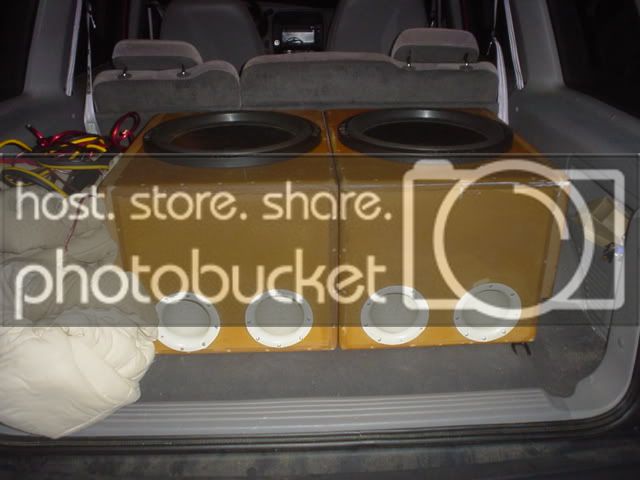

Heres how the truck started out in the morning, just a lil temp box i had in there to hold me over, got pretty loud, but lacked low end (tuned to like 42hz)
It was 2 soundstream t4 15''s and 1 powerbass 3000 with an interstate 8d battery.
And heres whats in it now:
4 soundstream t4 15''s, 2 powerbass 3000's and 1 interstate 8d batt.
Box is 12cubes before disp, 10 cubes after, 120sq'' of port tuned to around 35-36hz
Thing gets insane, and actually gets to the point that it physically hurts to listen to it, and i havent even had the balls to turn up the amps and let it really do some damage
Looks good. only one suggestion hide them wires.
Yeah, i gotta straighten em out, was the last thing to do and i was in such a hurry to just hear it play. Im trying to figure out exactly what to do with that lilttle space. Probably gonna mount a highs amp there, since the bass is overpowering and i need a lil something to keep up.

Just metered it really quick, didnt really get a true test, due to the fact that i have a deck that I think has 1v rca outs, and my gain is almost all the way down (still have PLENTLY of headroom left in the amps- which ive played around with ALOT so i know exactly what they can do)
Got a 148 and change at 35hz. Not spectaticular, but I can guarantee a 150+ on music when i give them a lil more. My box is also moving when i burp, and wedges the box right against the tailgate. I'll update more when i get to do a better test
