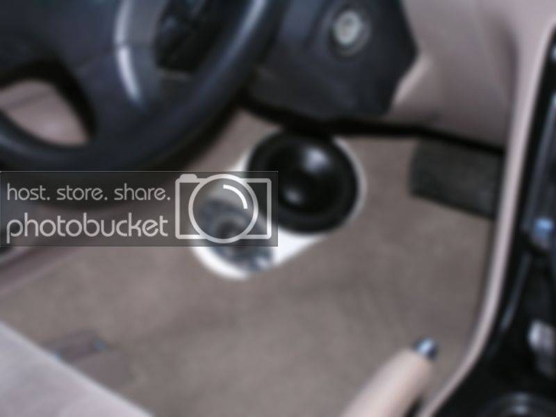

I have the R1's in my car...... but the Vifa's and the scan ring rev's are nothing alike other then both have a ribbed shaped dome and phase plug....
Good gravy you have $4000 worth of tweeters in your car! Daymn.
Of course they're not alike... if I'm remembering correctly, aren't the R1's using a photolithographed voice coil whereas the Vifa's are still coil wound wire?
And they're not even covered //content.invisioncic.com/y282845/emoticons/eek.gif.771b7a90cf45cabdc554ff1121c21c4a.gif I'm hoping something goes over those, but I don't see any mounting holes for a grill.
Seems WAY unsafe on the floor like that, either getting stepped on, dirt/mud from shoes or whatever.
