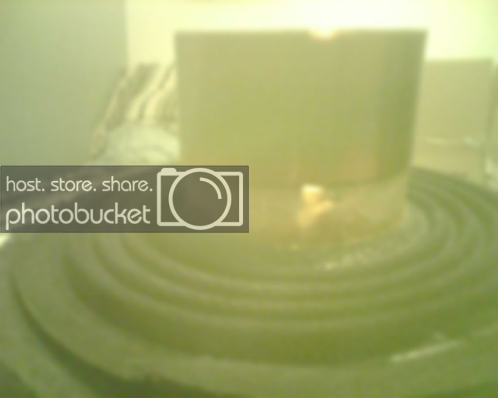

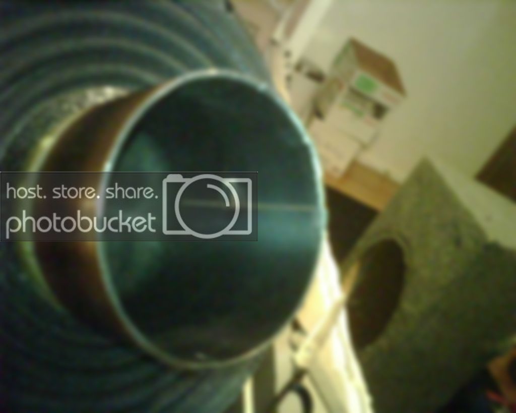

MT18 coil VS a custom coil I had wound for a DD9917 4" coil

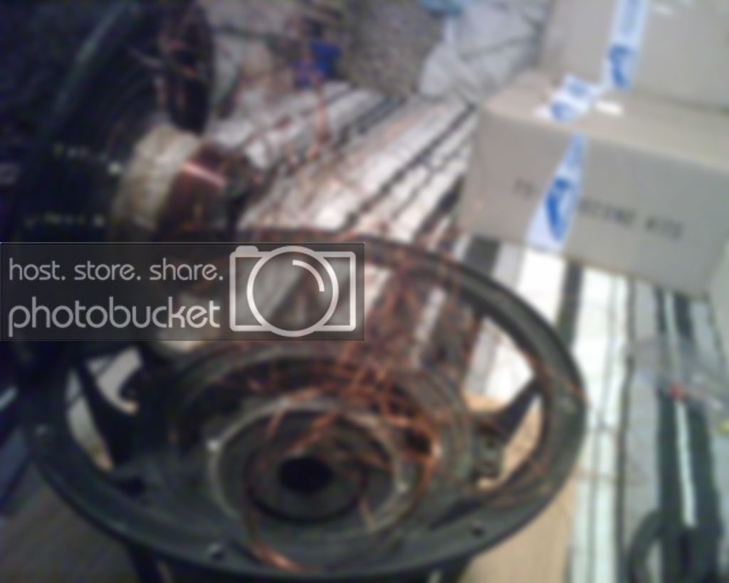

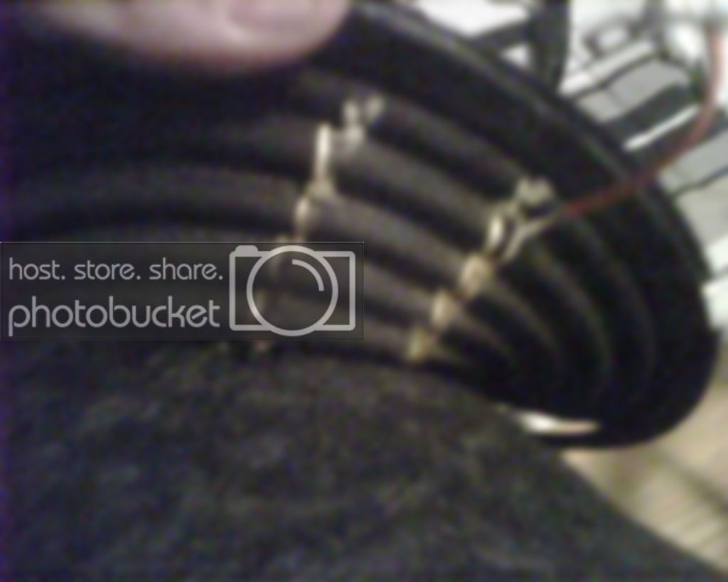

06XXX coils - //content.invisioncic.com/y282845/emoticons/smile.gif.1ebc41e1811405b213edfc4622c41e27.gif

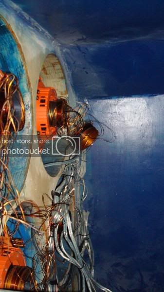

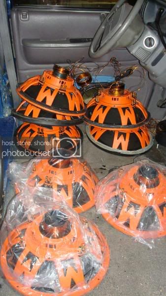

05 XXX 18" - The daler said it was a faulty sub! //content.invisioncic.com/y282845/emoticons/smile.gif.1ebc41e1811405b213edfc4622c41e27.gif
dave it dose look like a faulty coil, his faulty.
when coils start to darken it means they got hot and the coil glue starts to cook a little. it dosent mean they are ruined. when they turn all black like some of the pixs posted above they are shot. different coil manufactures coat there coils with different colored glue and some come black brand new, just not burnt,lol.

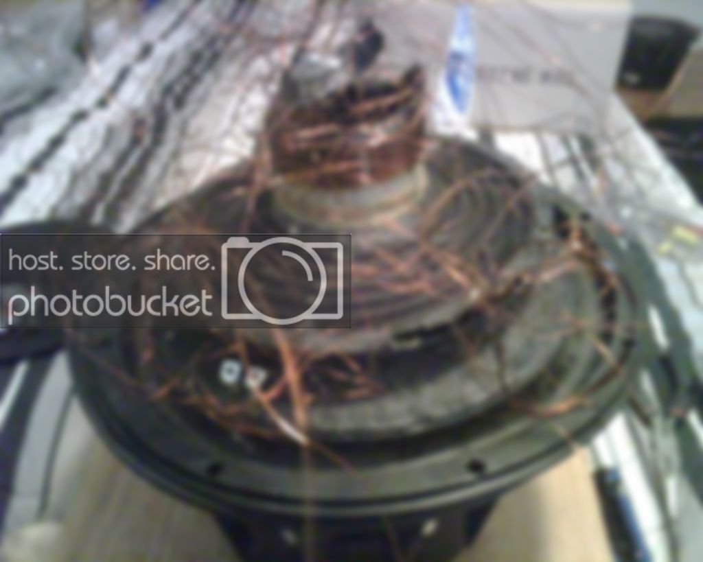

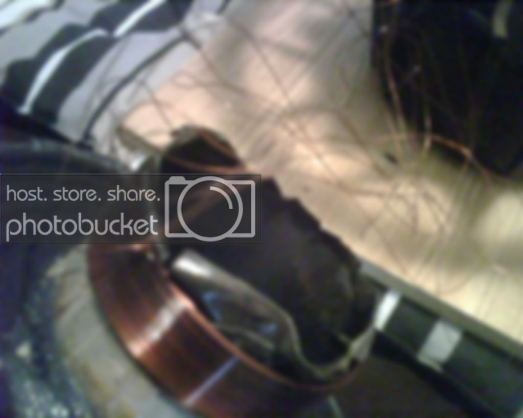

These are from my Soundstream t5-12, The coil came apart while I was dis-assembling it. I guess I over powered them or clipped them, maybe manufacture deffect. one has a freaking whole in the form.
