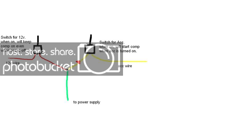

I went crazy with my power control.
First of all I have a power supply with a startup controller. It will turn on and off automatically with the key. I also have a switch wired up so that I can reboot the computer while the car is running without having to turn the key off (or keep the computer turned off when the key is on). And lastly I wired an unused channel on my car alarm to a relay so I can also start/shutdown the computer remotely with my 2-way remote.
