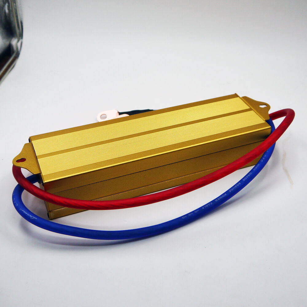

Would something like this work?
16V 83F Ultracapacitor Engine Battery Starter Booster Car Ultra Super Capacitor | eBay
