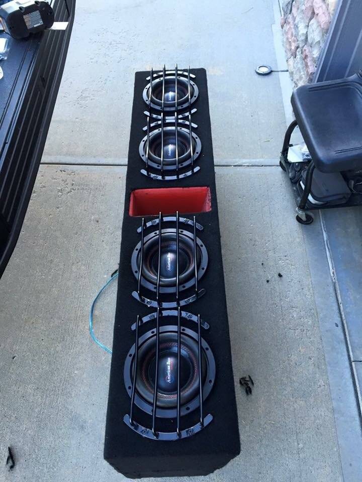

We did 4 8" in a sealed box a Silverado before. PM me or call/ text me at 281-315-6638 if you have any questions.
