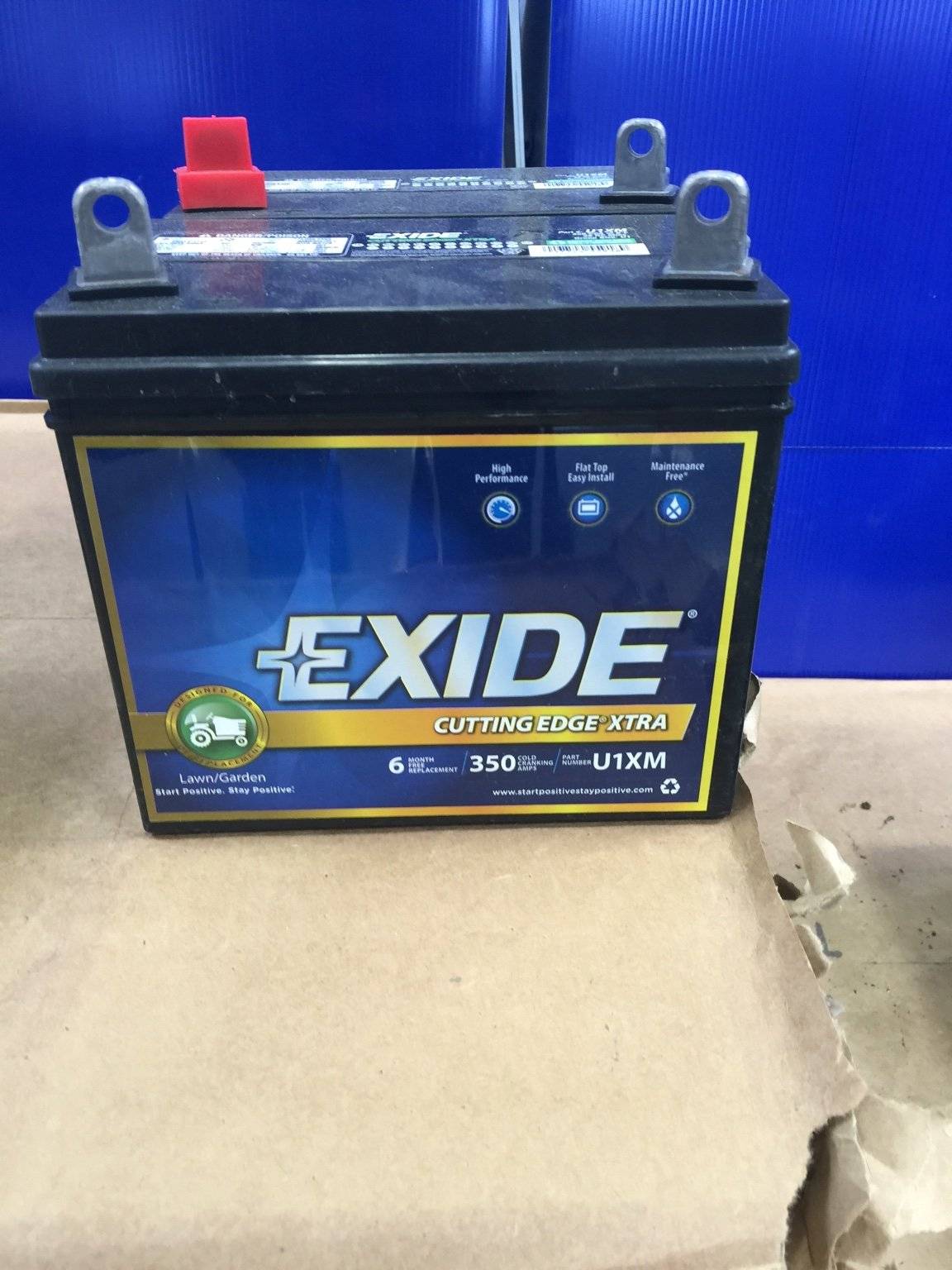

Without laughing too hard at me , would a battery like this help or solve my issues ? I only have about 900 rms on my amp on 4 gage but I do get some voltage drops of 11.5 once is a while when a deep bass note hits.
Yeah I keep an eye on the voltage , eventually I'll pull the trigger and get a good battery I'm sure but I'm holding off for now
