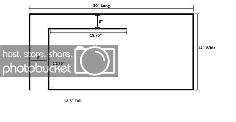

I picked up a RE XXX a few months ago with a custom built ported box..
Just curious on what kind of specs this box has cause I wanted to try putting an IDMax in it to see how it sounds.
The box is made out of .75" MDF with the exception of a 1" front baffle.
I think the poor paint draw out pretty much sums up the dimensions.
It is 30" Long x 14" Wide x 13.5" Tall with a 3" slot port.
The front baffle has a cutout for the port being 2.5" x 11.75"
Thanks in advance if anyone can give me roughly what kind of specs this box has. .
Oops, I forgot to add the front baffle has the port cutout being 2.5" x 11.75"
Would that make a difference? This box does not sound like it is higher than 35hz.
dang net volume is much smaller than i expected.
