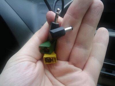

can anyone tell me how to use these wires that were for a sat radio (pic)?

I bought a used Lexus IS 300 and I was told when I bought it that there used to be a satellite radio installed. There were some holes in the dash for it. Well as I was swapping out the piece of the dash that had the holes in it I saw a 3.5mm jack. Sweet, I thinks, maybe I can plug in an MP3 player. Well, I plugged in my MP3 player but nothing ever happened. No big surprise since there were 4 wires and I only plugged in one.
Can anyone tell me whether I should be able to use these wires to play media from an MP3 player? Do I need to do something with the yellow and green wires and the back of my stereo? The CD player doesn't work, so I'm assuming that the sat radio was bypassing the CD player. The last guy who owned the car (for a short while) said he never tried to play the CD player so he didn't know much.
yellow and green are sat radio antenna connections. the DC plug was power for the unit. the audio jack may go back to an FM modulator behind the dash, or the guy may have just used the wireless FM transmitter in the unit.

I cracked it open and pulled out the head unit. At the end of the 3.5mm jack I found one of these:
Delphi SkyFi SA10003
Delphi SA10003 FM Modulator Allows you to add a Delphi XM receiver to any vehicle with an FM radio! at Crutchfield.com
Soooo, hmm. Plug in the MP3 and tune the radio to 87.9 Mhz or whatever the adaptor is set to? Well I'll go give it a shot. If you have any other ideas, let me know.

that one is specific to a Delphi system, so it's not surprising it won't work for a standard mp3. it needs a signal to turn on - probably the voltage from the sat radio receiver on the antenna cable.
