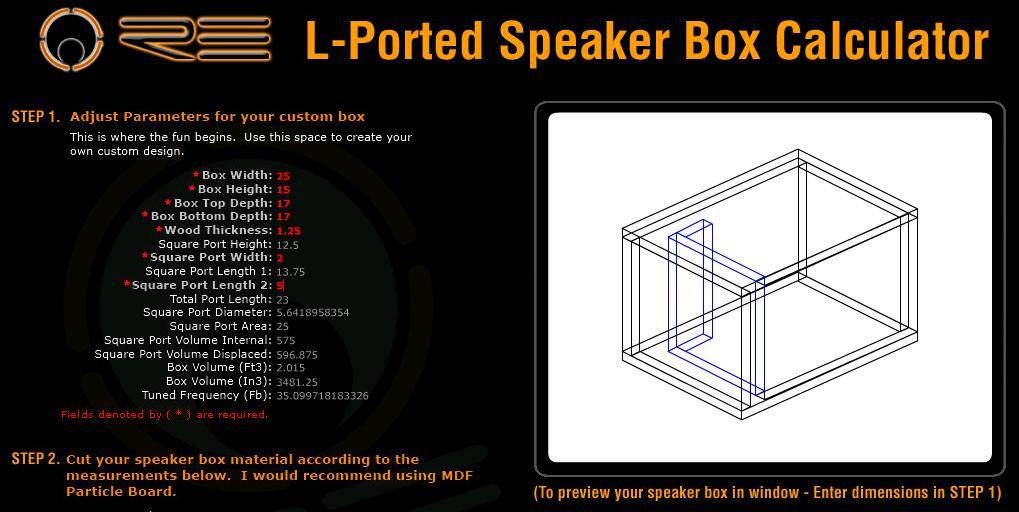

Is this a good box for the SA12?
Well for one reason, it doesn't incorporate the cars unique environment which greatly affects how it will perform, get a builder on here to design one for you
Well I have a typical sedan with the sub box in the trunk
The RE calc is just "off" a bit in most cases and never yields the same results expected after building it. Tuning is almost always off with RE.

Well, a standard size enclosure with a slot port is not all that large for a single 12".
You should be able to do a slot ported enclosure with 2ft3 and generous port area and be just fine.
