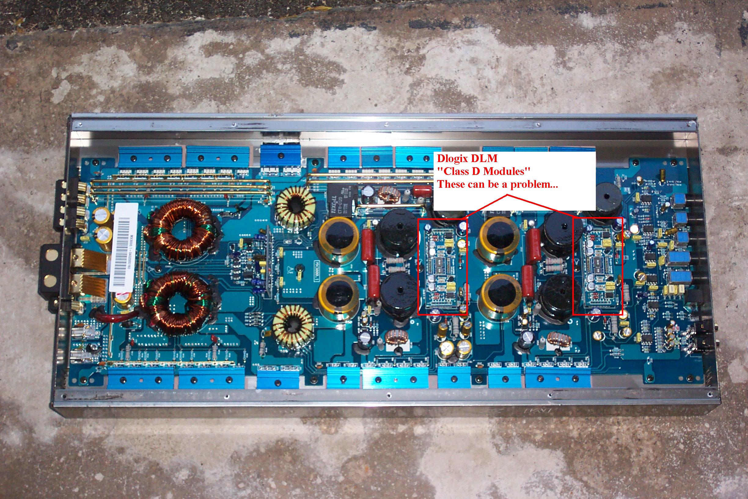

Calling all Chicago-ans!!! Blown Amp Help!
I sent you a PM and posted a pic outlineing the modules I told you about in the other PM's...
Looks like blown power supply... Last one I worked on like that (MX3000.1, MX5000.1 essentially the same amp, different power supply FETS, I have worked on both) had blown outputs too... though they didn't smoke, were just bad, was what caused the power supply to go bad was when some of the outputs went bad... May need a whole rebuild if the modules are still good you will be in luck.
