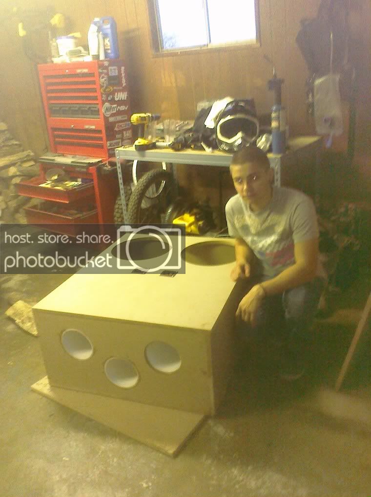

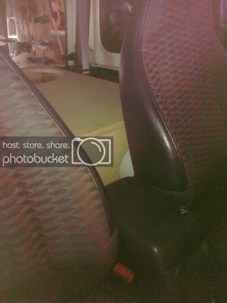

After going with a pre-fab box for my first system, I realize it sounded bad so I built my own this time. This box is 10.4ft^3 internal volume and is ported for 30hz. Should sound good with 2 15" kicker cvrs.
Is huge! looks good though. Hope you got it braced, you'd be amazed at how powerfull bass notes are. They will shake rattle and roll a big non braced panel and weak joints.
