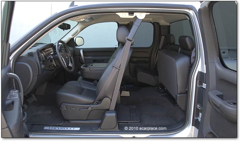

I'm going to utilized the enclosuer to take up as much room as possilble from floor to ceiling and door to door. They cut a 3/4 mdf beauty panel that will tuck very tightly around the widows and arm rests of the rear doors. The wall doesn't extend all the way to the b'pillar. It's about 4 inches behind it.
The box will stand vertically just a hair behind about where this seat headrest is.
