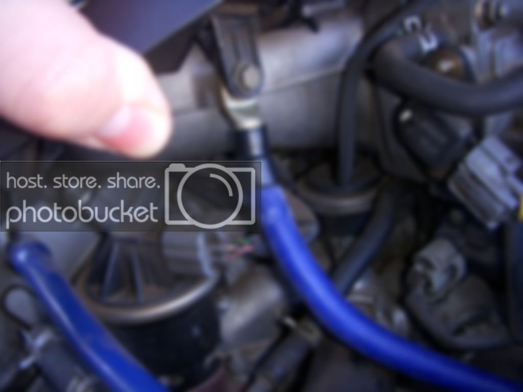

Oh, boy. You did something reeeeeallly wrong, bud. Pics of damage?
in 4 pics

Alright here is the pictureView attachment 26535192
