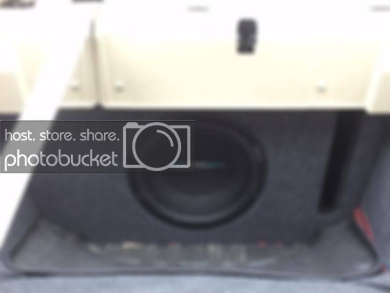

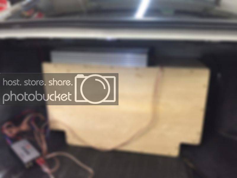

Hey all so I have a problem. To start off I'm going to tell you the system set up:
-2011 Honda Accord Coupe Stock Head Unit
-AudioControl LC2i
-4ga OFC
-Brand new Hifonics BRX5016.5
-Crescendo CZ 6.5 components
-ID IDMAX 12" V4 D4
Ok so everything was installed and the amplifier went in to protect thermally. Things I've tried to correct:
-Redid ground even better than the good ground I had, overheat
-Tried turning down LC2i level and turning up gain on amp, overheat
-Turning up gain using AudioControl instructions and turning gains down on amp, overheat
-I installed a Stinger fan on one side to cool it down, overheat
-I checked all the impedance on the components, 4ohm, IDMAX, 2ohm. It checks out.
The amp is hooked up to the sub at 2 ohms, channels 1/2 & 3/4 are bridged to run the front components. Amp is on 5ch mode and hooked up exactly as it should, I even called Hifonics and asked. My voltage doesnt drop below 13.8v when its cranked. I also need to add Accubass for the sub to hit the lows or anything below ~35hz is practically non existent, I tried switching polarity it didnt do much. HELP
