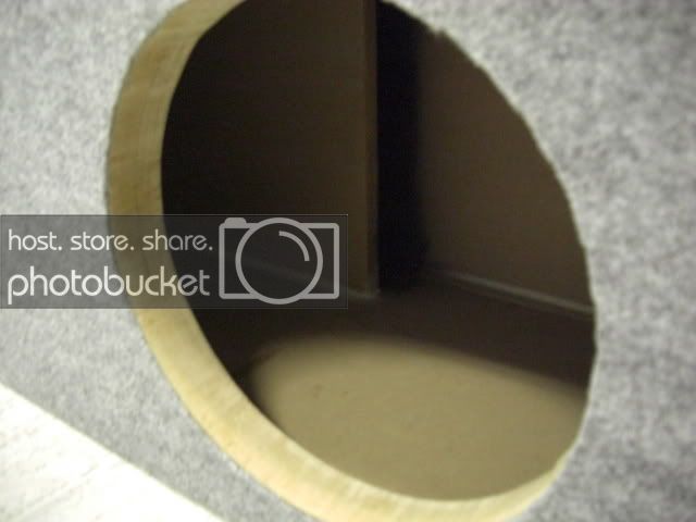

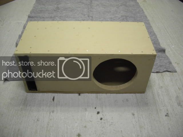

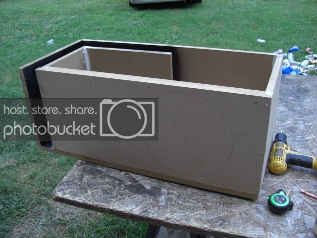

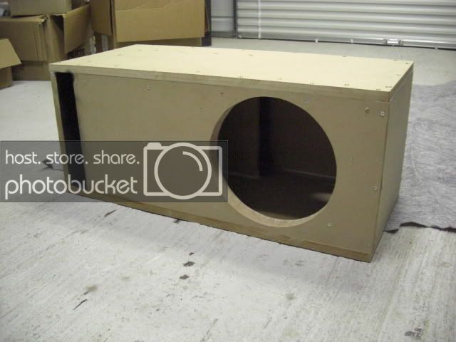

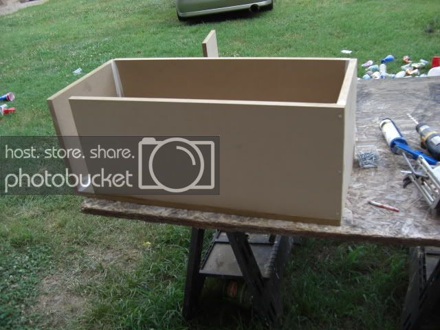

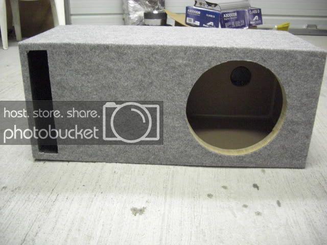

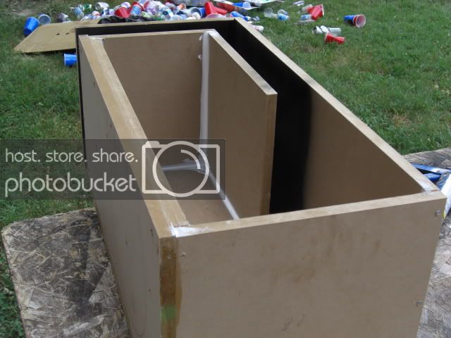

External dimensions are 32.75" wide, 13.75" high and 14.5" deep. It's double baffled, has a gold plated, set screw down styled terminal cup that accepts up to 8 awg wire and is carpeted grey. Port is 2.5 inches wide and has 30.75 sq. inches of port area.

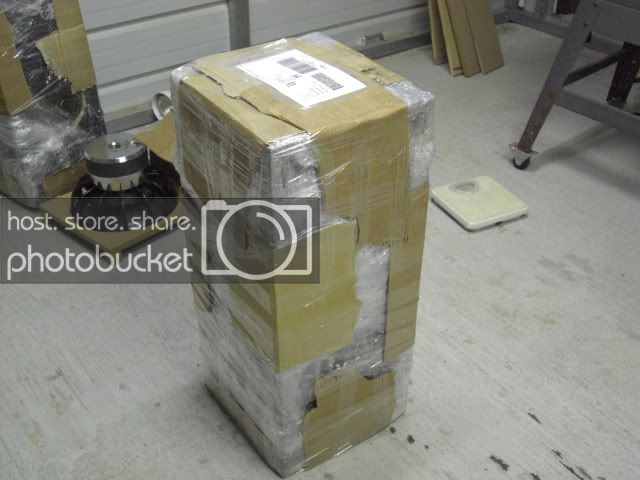

On to the pics!
He should have it a few days after the 4th of July so I'm sure he'll chime in and let us know how it sounds!
