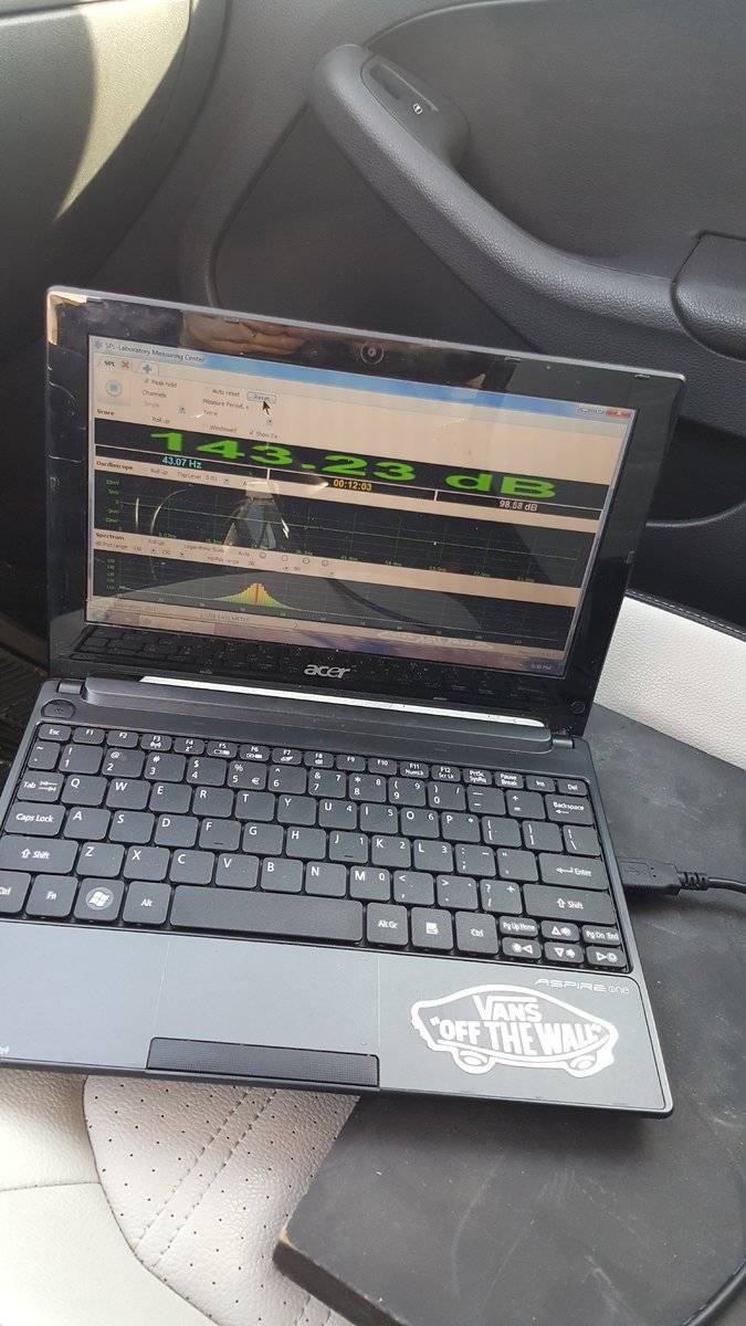

This evening I did some SPL testing of a pair of Blaupunkt 10s. The results are quite impressive imo.

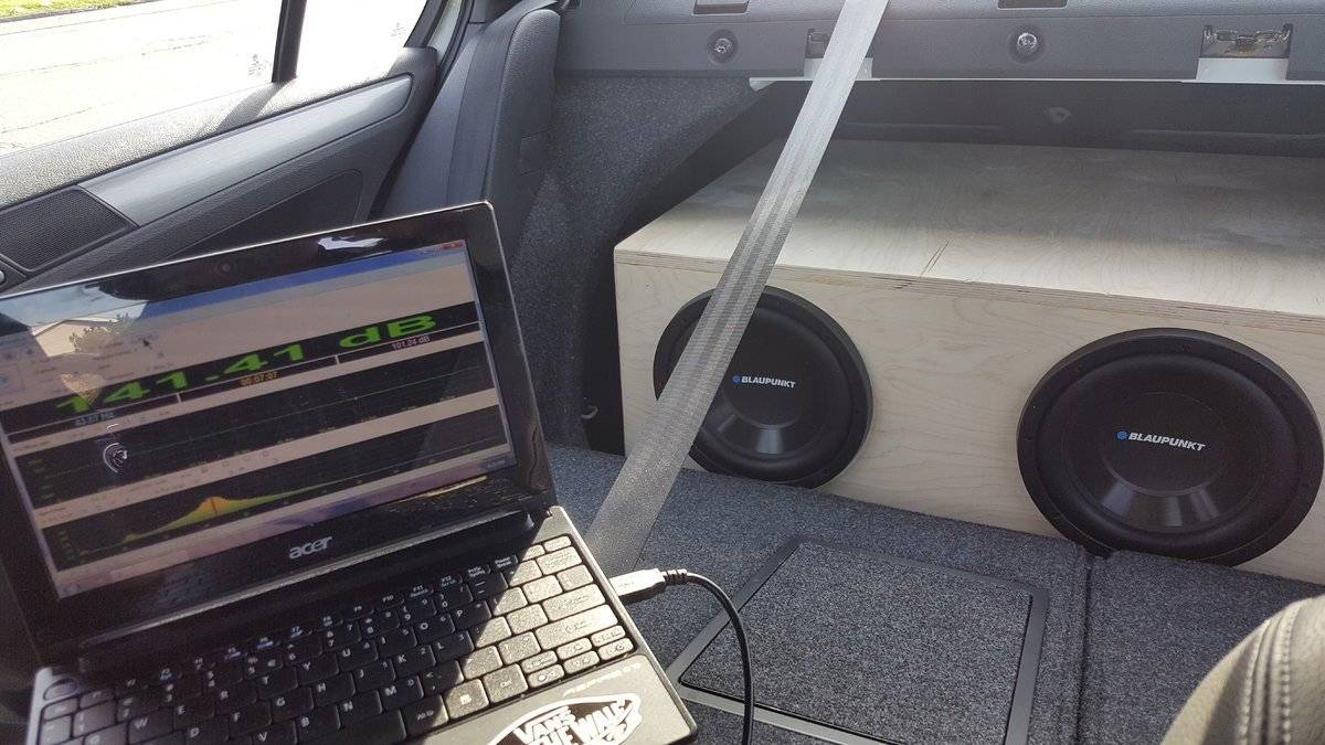

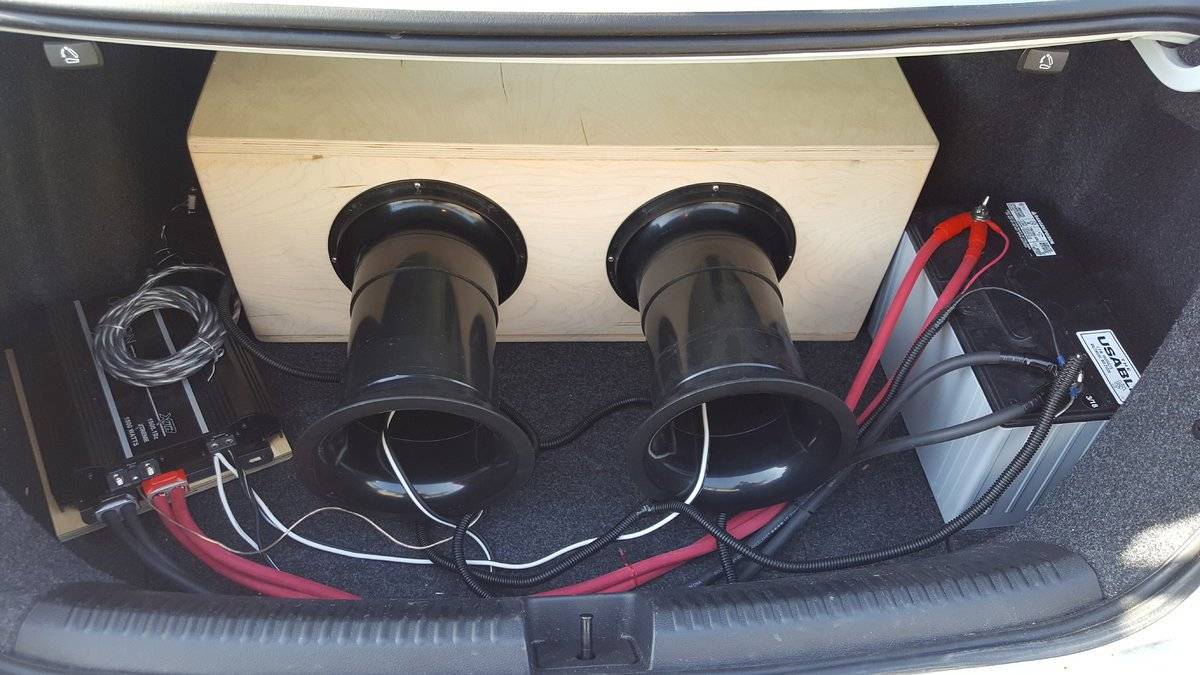

The box is a burp box designed for Sundown E10s that I was running in my girlfriends Mustang. I thought my Jetta would peak close to the same as the Mustang, turns out it peaks about 4-5hz lower, so the tune isn't ideal for my Jetta. I'll let the pics speak for themselves.

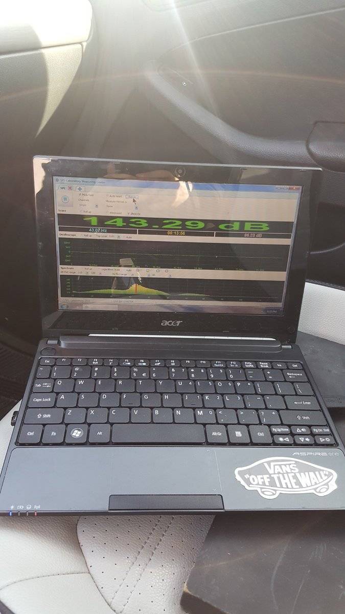

The meter is a USB SPL Lab and I made a jig to meter at the headrest MECA style. I bumped the gain the thickness of a hair to get it to jump from 141.41 to 143.2x. Not sure on what kind of power I'm clamping, I just picked up a clamp meter but didn't have it set up today. The battery wasn't fully charged either and was resting at about 12.6v. So less than 1000w for sure.

Only half of the screws holding in the ports, not all port joints were taped and the battery wasn't fully charged among other things. It's tuned to 46hz, the car peaks at 44hz so I know there is more left in it, the question is how much. As it is right now I'm guessing I'm soft clipping at the battery voltage I have. This is a stand alone system, there is no connection to the vehicle's charging system.

I ended up doing a 144.53 with these Blaupunkts on an SSA meter on the windshield with the door open! I metered 1.5 db higher than an EG Civic hatch with 2 XFL12s at .5 ohms on a AB VFL 120.1.
These things are seriously insane for money! I was louder than several setups that should have blown me away.  I'm going to continue running these this summer and keep testing and tweaking to see how much more I can get out of these things. I know I am definitely clipping them but I don't care I just want to push them to their limit in pursuit of the highest SPL score I can extract.
