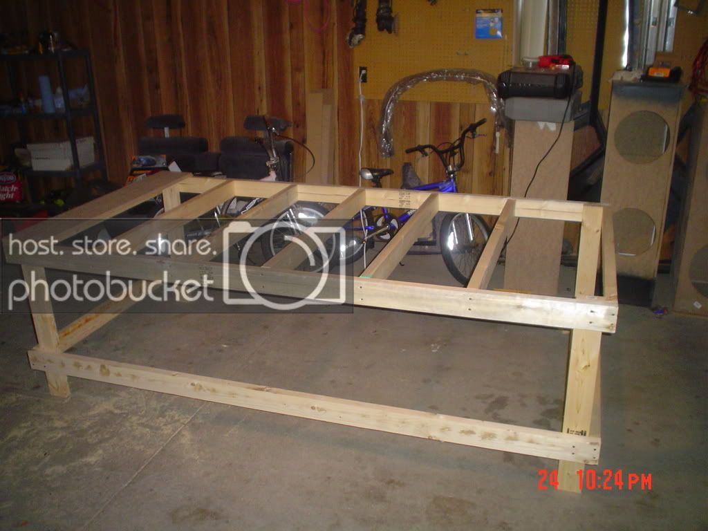

X2 million....i had this issue sometimes so i built myself a table that will support a whole 4x8 foot sheet
