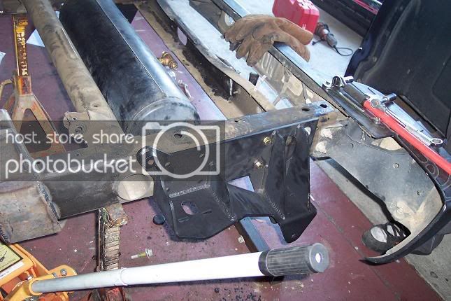

those are brackets we made to hold my 2 thomas 337 air compressors welded in to my stock crossmember
Might I suggest plating the frame before and after the notch at least a foot each way?
Other than that, it is coming along.
the frame is boxed stock right before the notch and we did box after on one side. the other side is where the bracket for my pan hard bar goes so we cant really box that in.

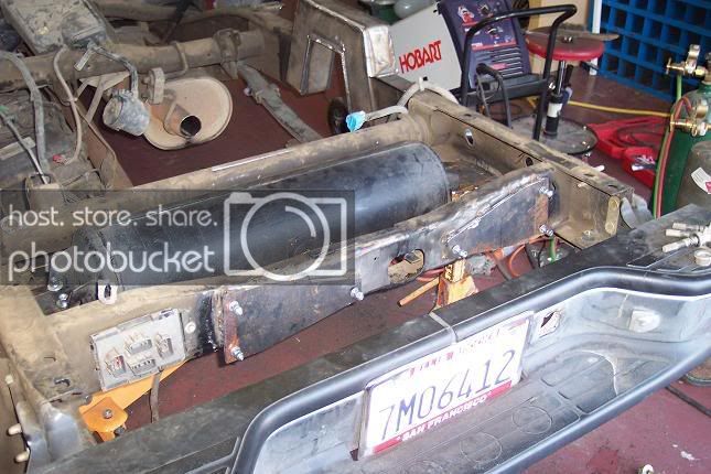

The right C notch looks like it bows inwards, whats up with that ?

thats just the pic. acatually the bottomof the notch is a bit wide so its flush on one side and the other theres a little extra metal making it look like it bows . yes hobart makes welders and yes those sports drinks are good. we killed so many of those all day we all went out drinking the night before so everyone was a little hung over. and trust me i did my fair share of work.
