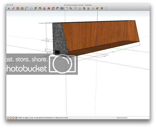

So I realized that only one 8" will work and i'm wanting to go ported so my question is will these dimensions work? I'm still trying to figure out the port calculations but I'm just hoping I'm on the right track. Trying to tune to 32hz.
If you can't read it, port is 2"Wx1"Hx4 1/8"D. Any help would be appreciated.
I cant read any of your dimensions, and I cant help you anyway cause Im a noob at this stuff.. but in Google Sketchup (at least on windows) you can go to file, export - jpg and save it that way then upload it. Works better.
