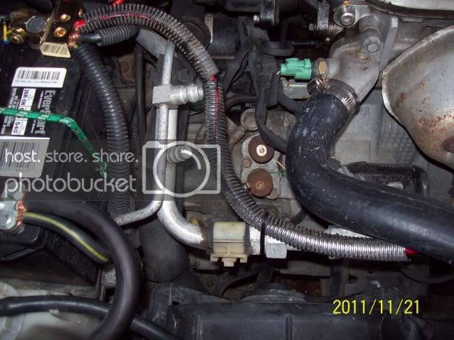

Look at this picture of my Big 3
If my wire running from the alt to the battery touched the exhaust metal (for example) if the wire was fused at the battery like recommended that fuse would blow but there would still be a direct short from the alt positive to ground. How would the fuse at the battery prevent a catastrophic electrical failure - it would not.
What is MOST important is making sure the wire from the alt to the battery cannot ever melt and touch metal.
I only put mine in recently - I will be covering mine with TechFlex (a heat resistant covering) however right now it is firmly ziptied to the a/c line which is inches away from the exhaust.
looks like a honda there with where tha alt is

kinda scary, where can i get some of the stuff to put around the wire that is very heat resistant?
Techflex works well. TBH it's not really necessary if you run your wire correctly. If you think it might be close to the engine block, buy a couple extra feet and reroute it a different way.

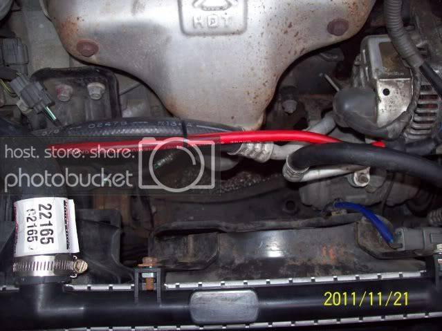

IMO, I would do a long run around the back rather than doing a run right in between the front components there. Better to just do it the right way the first time than try and bandage a future problem, I guess.
I disagree - did you look at the pic. Just a short run from the alt to the battery would be fine -- 18" would be plenty
Roux has a high end crimper - some of us do not -- I prefer a battery terminal with a bunch of holes in it.
Also don't you think (Roux) that a longer run is more likely to have a rub or heat burn than a short run??
