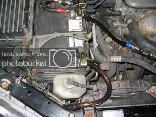

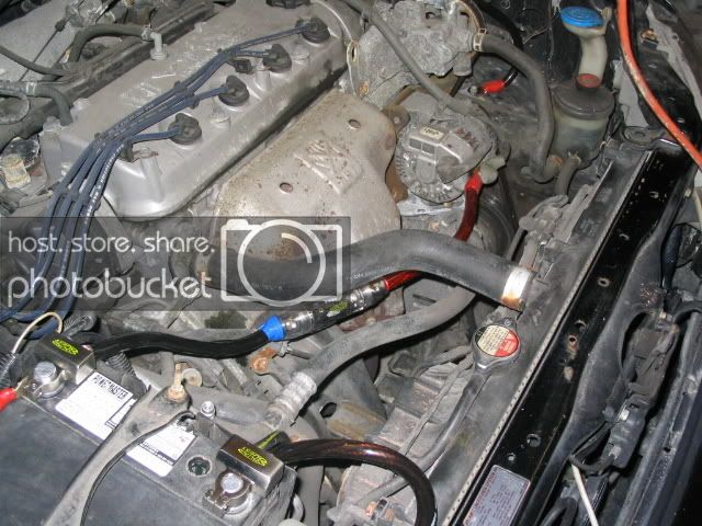

Ok so, I got all soundquest platinum products. The fuse worked great and the multi-terminal block not so well..

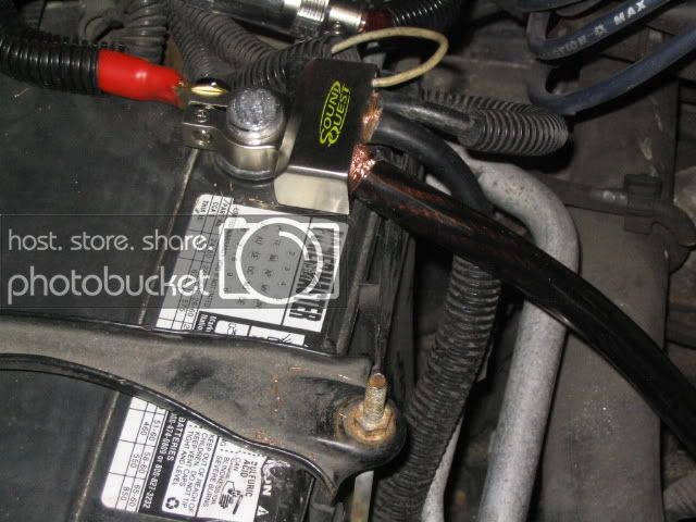

As you can see in the pics the wire is pushing up againts the terminal because its a wee bit to small..(is this alright)?
anyways yeah so here my pics ha
The wire pushing up againts the terminal..
on 98 accord LX 4cyl

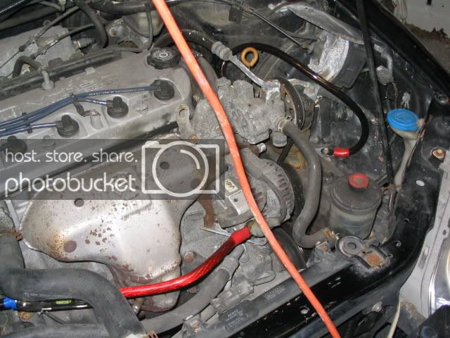

you may wanna put some heat shield on that inline fuse(plastic), beings its so close to the header
i say you re-route that pos to alt wire cause of the headers being so close
edit: I say go against the fender back to the back of the brake fluid to the alt
