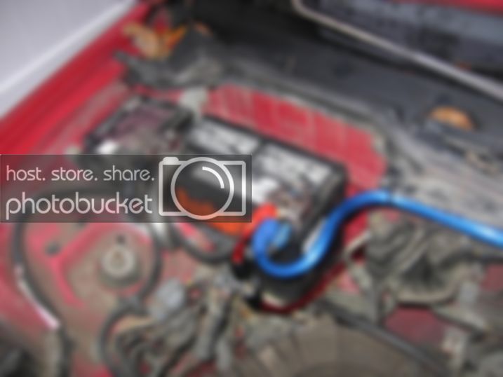

Chassis to battery negative. The postive terminal is full to the brim. The stock wiring going into it took up both holes so I put the alternator + and amp + into the top ring terminal part.

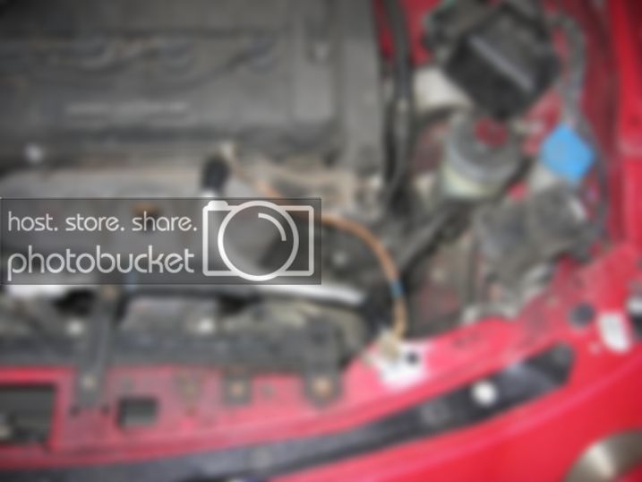

Engine to chassis ground.

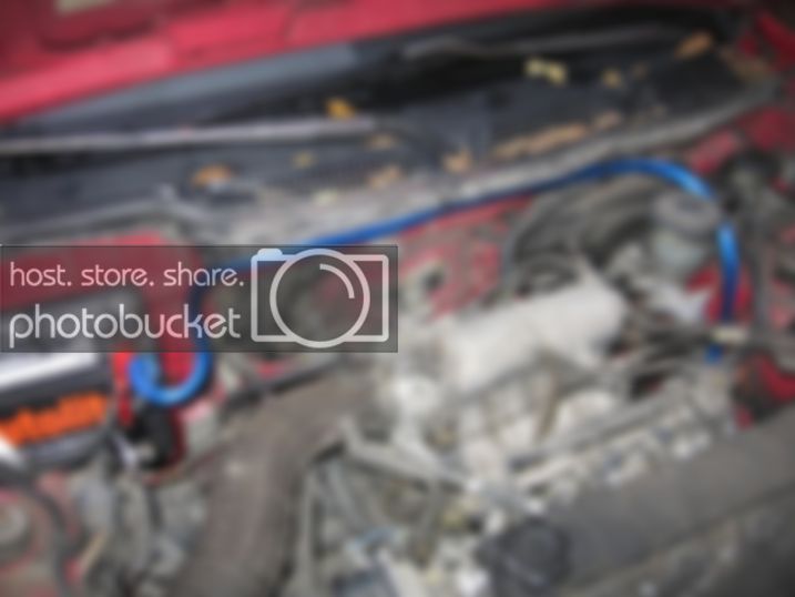

Alternator + wire. The alternator is a couple inches below where the wire ends in the pic. I tied the wire to wall with existing clip holes. I took the clips out.
That wire is ****ing huge.
