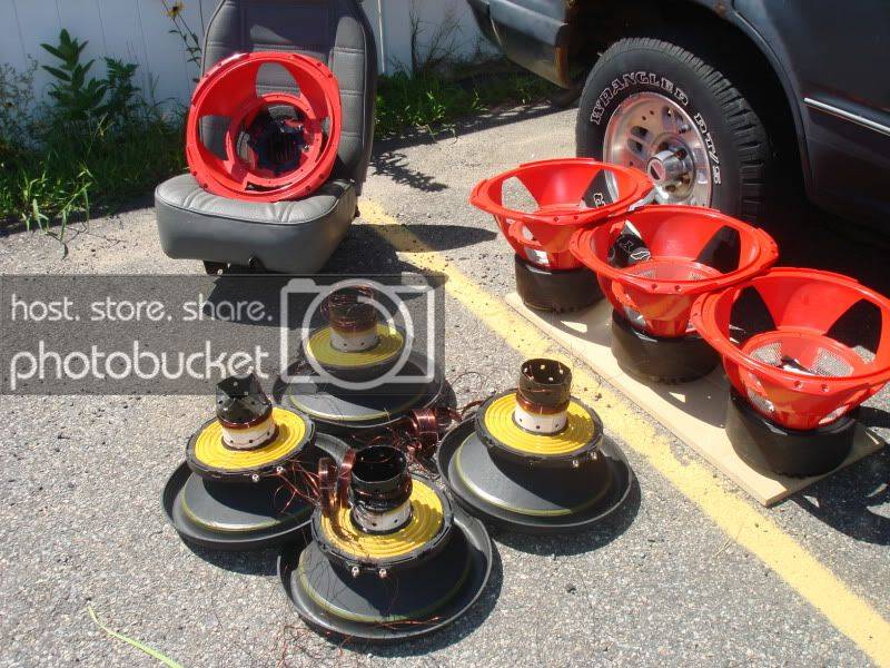

Be very very caerful attempting to give this woofer more than 2KW continuous...even there I'd be careful. They are only "rated" to handle 1200W IIRC. Orion claims in their marketing how they handled over 6KW before they failed. Please do NOT try this at home.
....pic related HCCA subs that were fed 4KW... catastrophic thermal failure in
Tune low, keep 'em under 2KW and you'll be happy, they're a beefy sub for ground-pounding I think, but don't think they'll handle power like a DC Level 5 or T3 or DD 99XX
how come u didnt post that picture on my post hispls!!!!! thats a game changer for me and my thoughts of the hcca
I still think they'd be great ground pounders tuned low off 2KW ish. They are mechanically very very rugged and overbuilt, just thermally I wouldn't trust them with over 1500W for too long. I'd power them with 2KW a piece and just back off if they start smelling.
