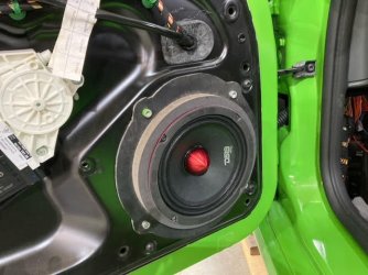

4way planet audio(100X4) amp pushing DS18 6.5" doors and 4" rear components.

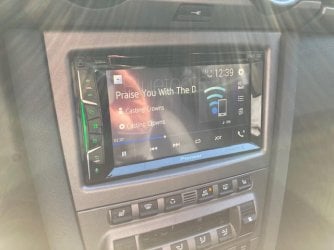

Pioneer head unit.. very happy with the radio.

Aslo any thoughts, ideas on how to get this all tuned in for the best sound? Those DS speakers are crazy loud but to get everything to blend with the right amount of crispness, loudness and bass.. kind of eluding my brain.
