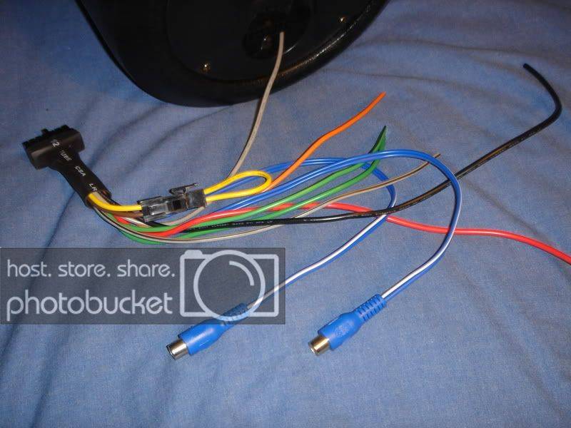

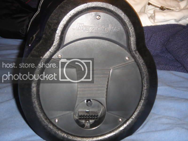

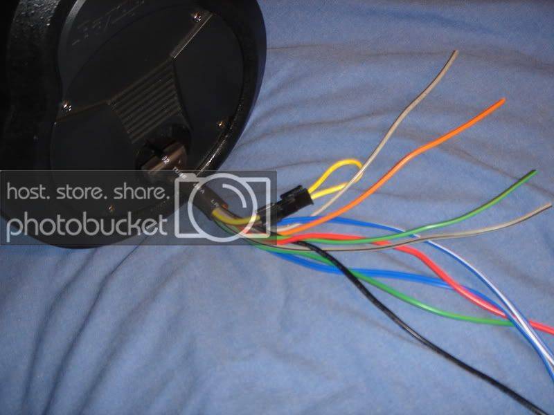

okay i know bazooka tubes are the best but my friend got one and he wants to put it in his car. i told him i knew how to do the basic install and then he brought my his bazooka tube. i looked at the back and have no idea what the hell i see. its just a harness with wires stickin out..

I hate those things. I had to install one at work the other day.
Red: Power
Black: Ground
Orange: Turn on
i see.. so its all hooked up to the headunit??
wat about the green, grey, and yellow??
is there some kind of kit i can buy for this bazooka?

No the only wires you are connecting to the head unit is the turn on and RCA's. I ran 8 gauge to the back of the truck and soldered it to the harness. I also used 8 gauge for the ground. Don't worry about the other wires, just tape them up neatly.
oh i see. so the orange is the remote. and then for the rest of the install it is your basic power, ground, and rca.
one more question. for the ground and power i should use a 8 gauge? is that too big? because the red and black on the hardness is only a 16 gauge.

I believe its 12g but you can just solder it to the 8 gauge
its a 16 gauge.
so this is how it will go. solder the power and ground, hook up the remote and rca's and it should be set? and the other wires i should just tape up?

alright i think i got it. thanks for the help.. only thing weird is that the rcas arent labeled differently. how would i know whats left and right? does it matter?
