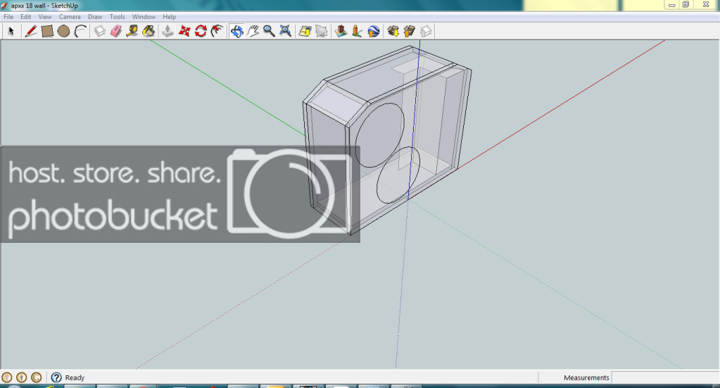

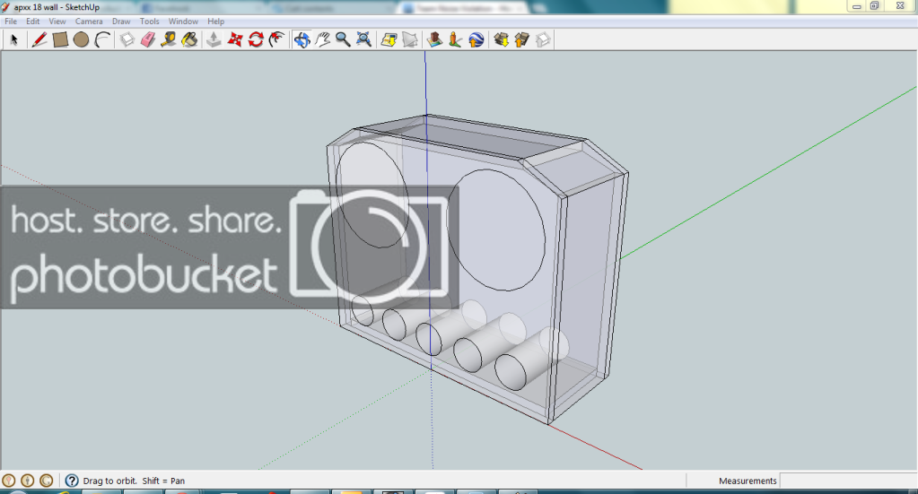

whatcha think.... 12 cu ft net tuned to 43hz with 5 6 inch aeros
its for 2 apxx 18s on 10k
opinions???
slot port sir. angle the subs to squeez as tight and to the passenger side as possible. one on top of the other or at least as close to straight up and down as you can. then do your slot port on the driver side
well see what it will do.... I think that that much cone area is gonna put up some impressive numbers in a small cab... This build is gonna be a while though, I need to get my first build done lol
well shes still my daily driver and I will be playing music and demoing... 46 is about as high as I would like to go... I need at least a 155. think its possible??
There is more to it then just the enclosure at that point. I would say do a removable port for daily though. That way you have an SPL setup and daily with out much hassle.
