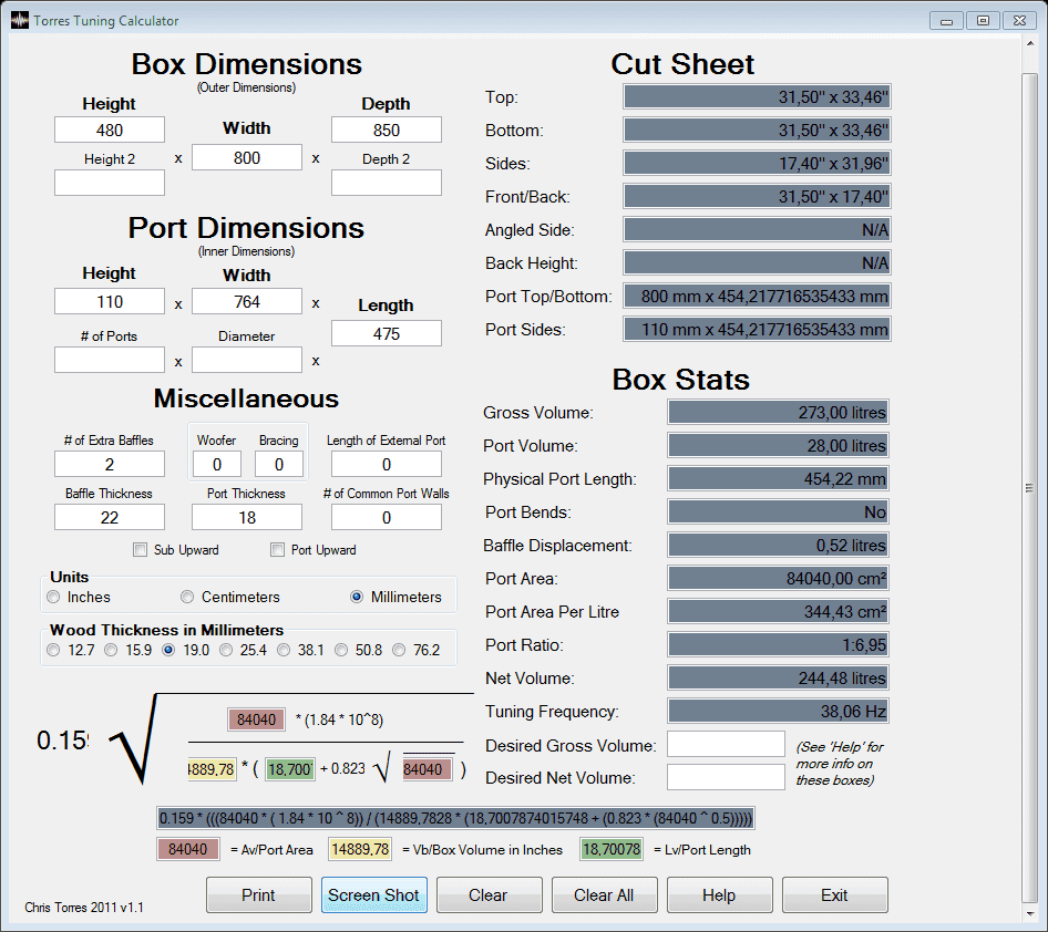

Hey, i've bought 4 bassface spl 12.2 and i'm having trouble calculating slotport area and lenght.
Going for 38Hz
The enclosure is 8.5ft3 without port and subs.
Going to mount the subs with magnets outside of the box.
Best regards Axel

You underestimate port displacement. You'll also want to do a double baffle along with proper bracing. You'd want at least a 9.5 cubic feet gross box if you want to do a proper slot port. Even with your current box right now an aeroport will not keep you anywhere above 8 cubic feet net and aeroport setups take up significantly less airspace than slot.
Download torres box calculator while you are at it.

No, your car is hatchback, make use of that hatchback horn effect. Subs face up, port face to the rear towards the hatch. You need proper loading, front loading is horrible unless you make a complete wall blocking off the back cabin completely like this.
Defintely download torres box calculator
Here's the main page/tutorials
Torres' Box Tuning Calculator - Updated 8/18 - Subwoofers / Enclosures - SMD Forum
Here's the download link.
TorresBTC
You need to get the numbers right before you start drawing stuff up to be honest.
