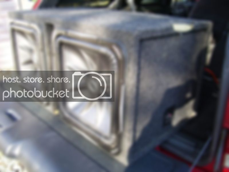

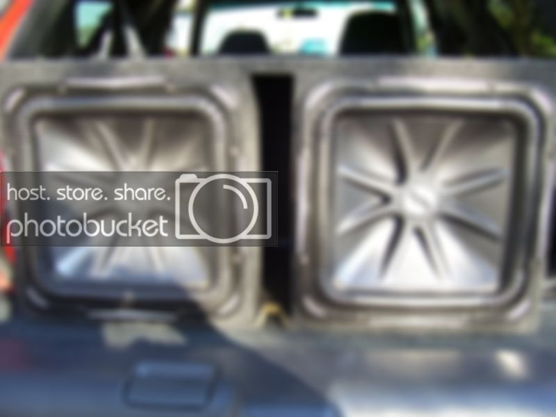

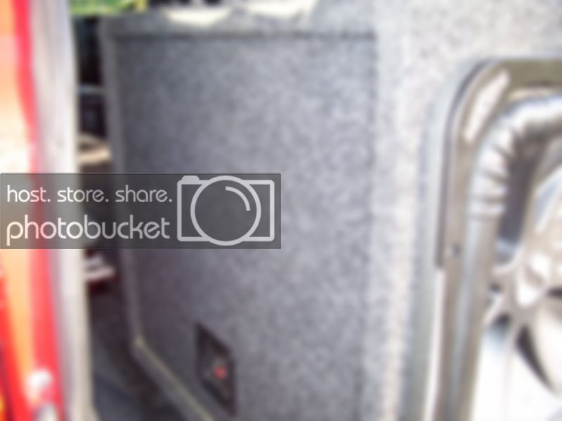

REALLY need to know your current enclosure specs before we can help ya man. if you dont know the specs, take some outside measurements and some pics of the box. With what you have it should be VERY loud and you should deff. feel it
The box is just a prefab. I know its probally way too small. Any links or plans for a box that will fit a 2dr blazer for 2 15 L7s that will give me the bass i want?
