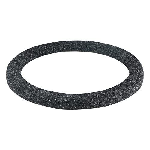

Available on amazon $11.10, query:
Atrend Universal MDF Constructed Spacer for 10 Inch Speaker or Sub - Adds 3/4" To Depth - Premium Subwoofer Spacer Improves Audio Quality, Sound & Bass - Multiple Usage - Charcoal,Black​

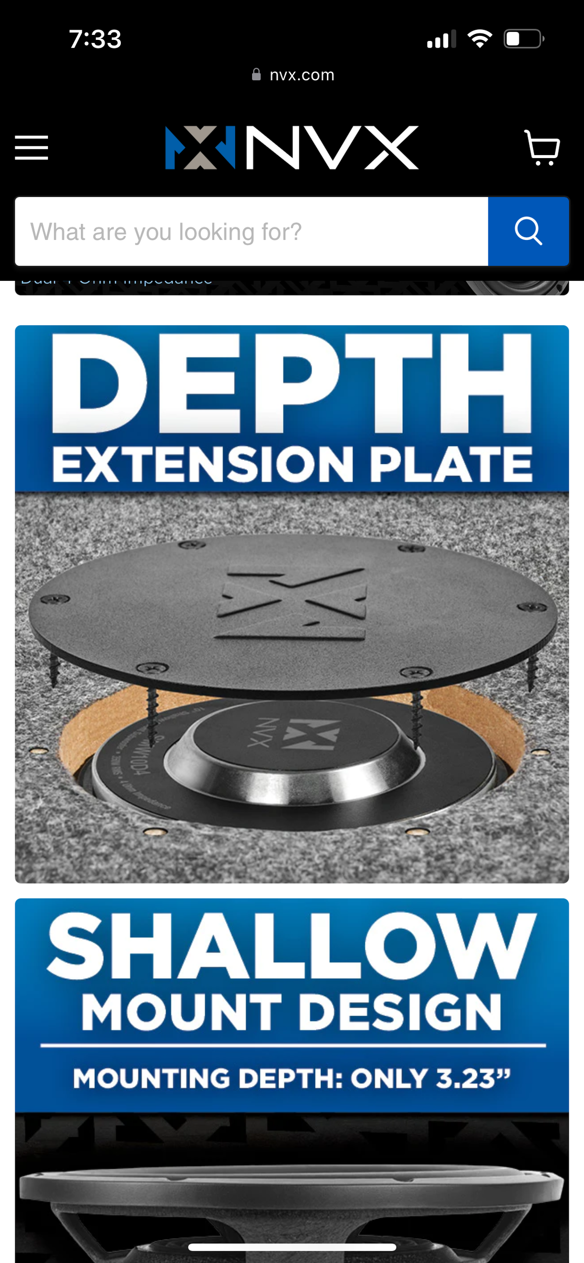

Now to answer your question regarding the space in the back i am using this plate to give additional 3/4 clearance after this cut out i will have 3/8 of airspace if it needs more i would have to put a ring or anything to lift it but as far i think 1/8 shouldn't make much difference what do you think ?

That was going to be my other suggestion and will work if you prefer.
