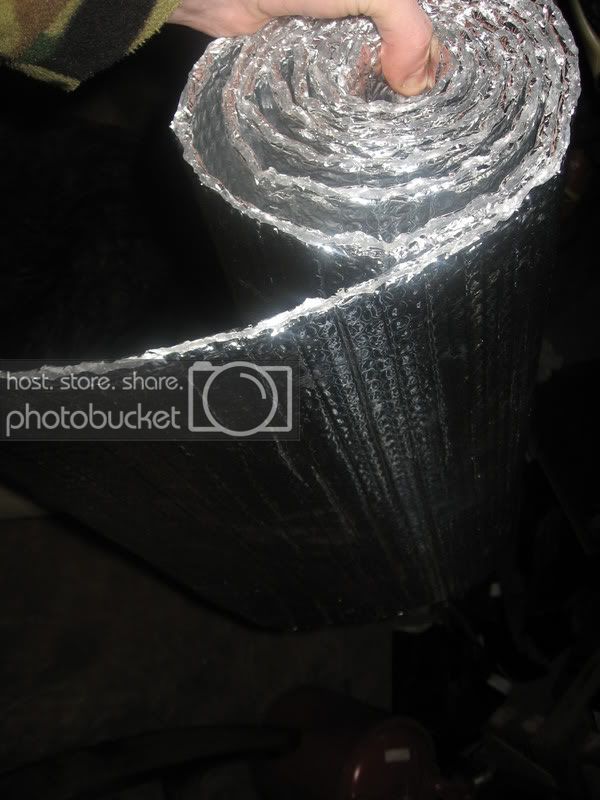

well thought i might be able to help most people say sound deaden your trunk with second skin raammatt dynamat etc.....well i did alot of research and found this stuff at lowe's store for $24 25x35 a roll it did my whole trunk 3 layers on the trunk lid 2 on the bottom my trunk isn't that big but you can alway's buy more if needed anyways. And man what a diffrence:)//content.invisioncic.com/y282845/emoticons/smile.gif.1ebc41e1811405b213edfc4622c41e27.gif.
What is that i used peal and seal?
