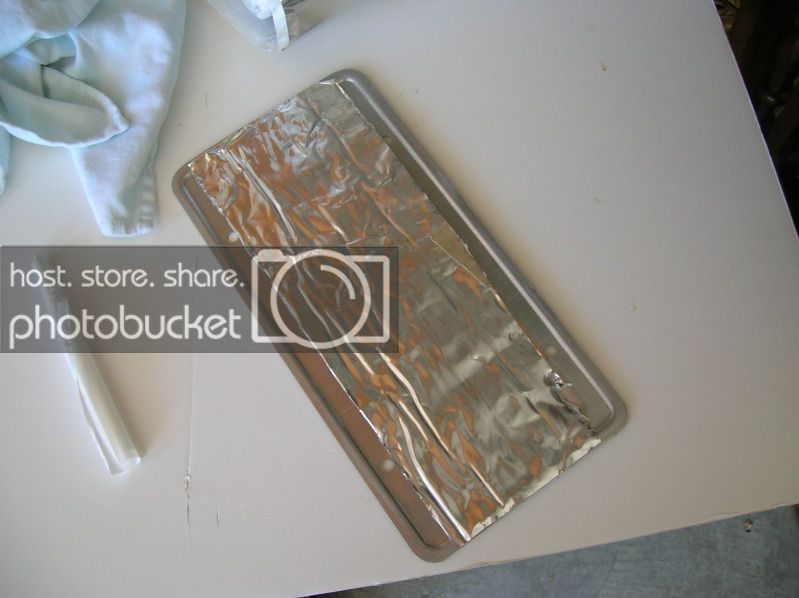

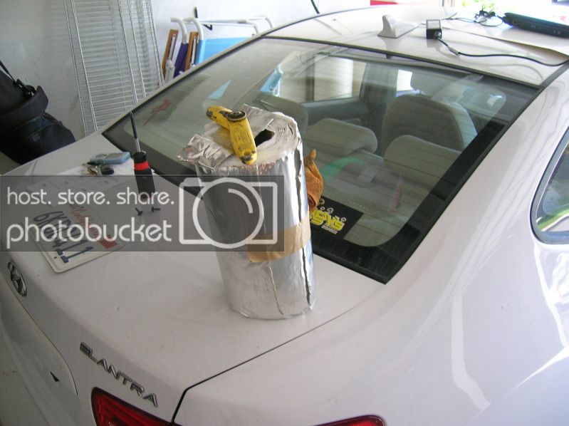

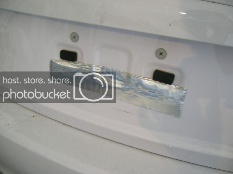

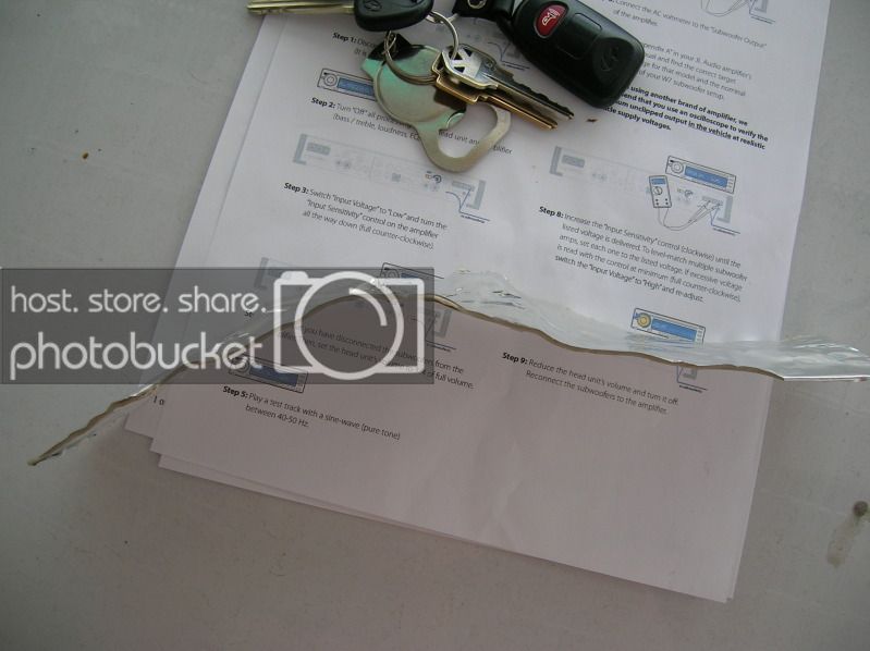

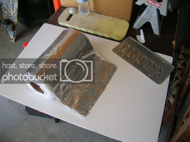

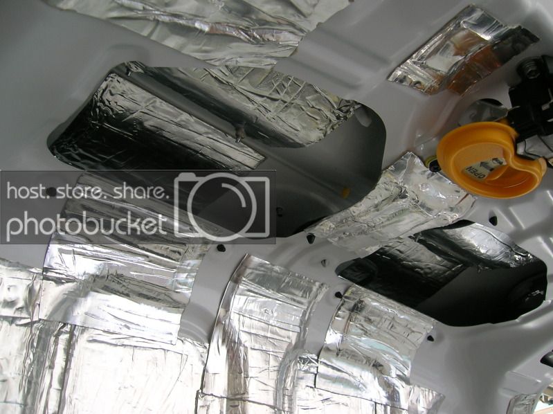

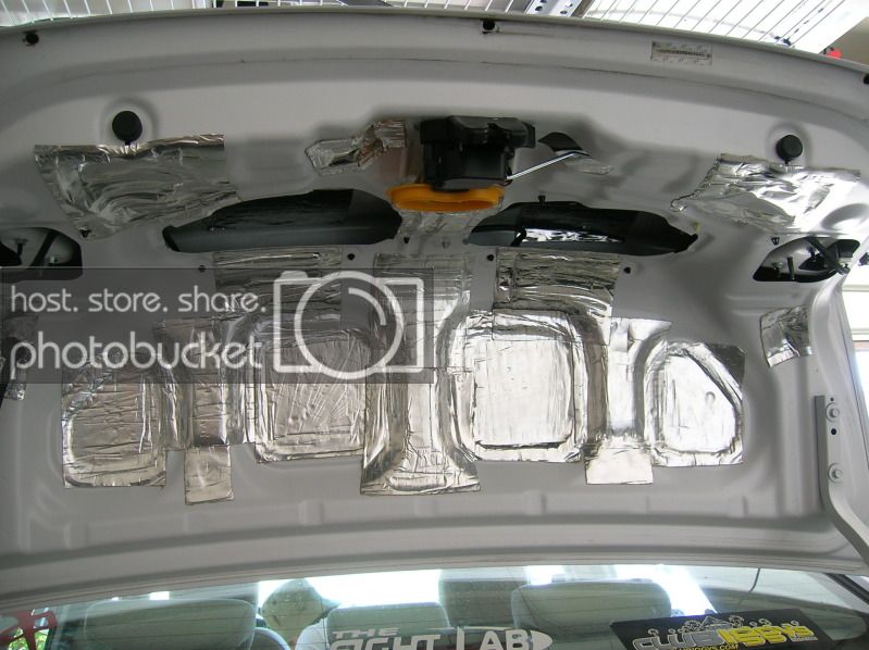

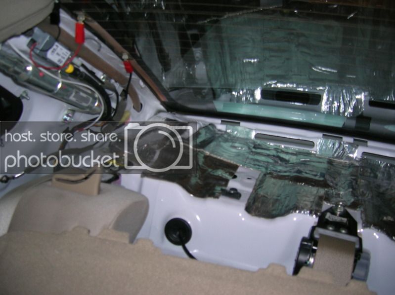

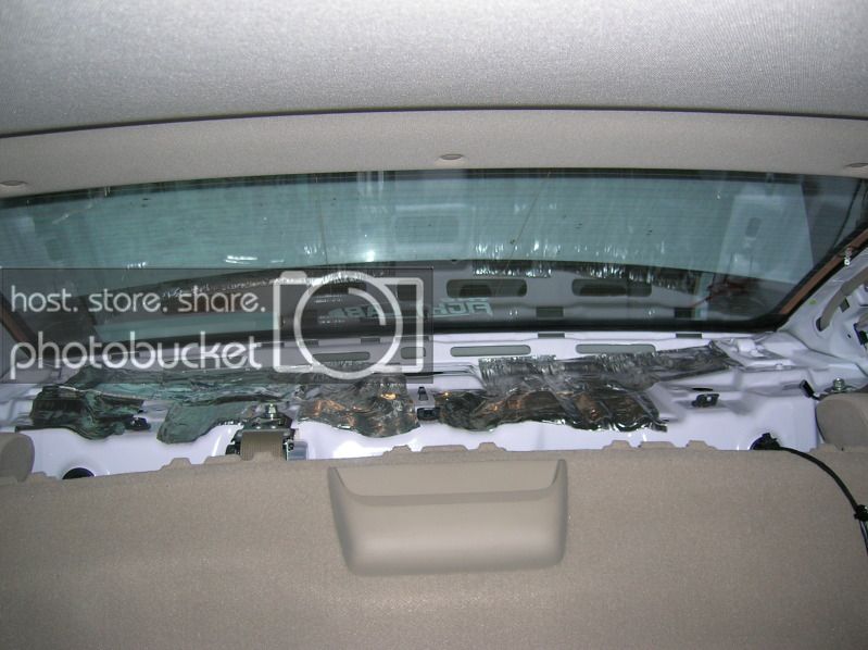

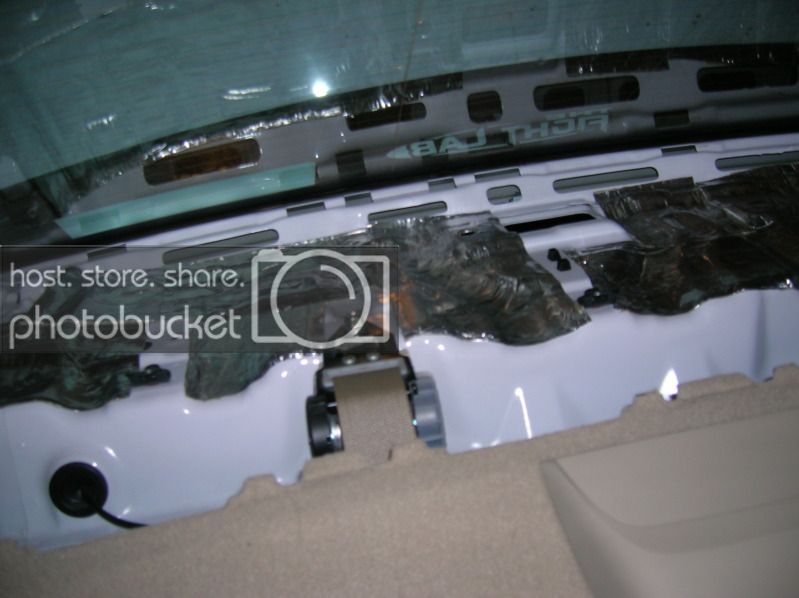

pulled the trigger. Got 25sqft of the 60mil to deck out my trunk and

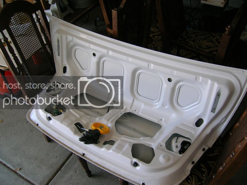

license plate of course. I bought a roller with it, and made sure to
rub all the areas down with rubbing alcohol first for a clean stick.
Everything pealed off very easy. I had no problems cutting or molding
it to anything. I didn't cut my hands up? I'm not sure how people managed to do that. But I'm sure when working with lots it, it could get messy, I didn't have any of those problems.
When buying it, I had quick PM response, and very helpful. Shipped right away, and was at my door in less than 5 days. What more could I ask for?

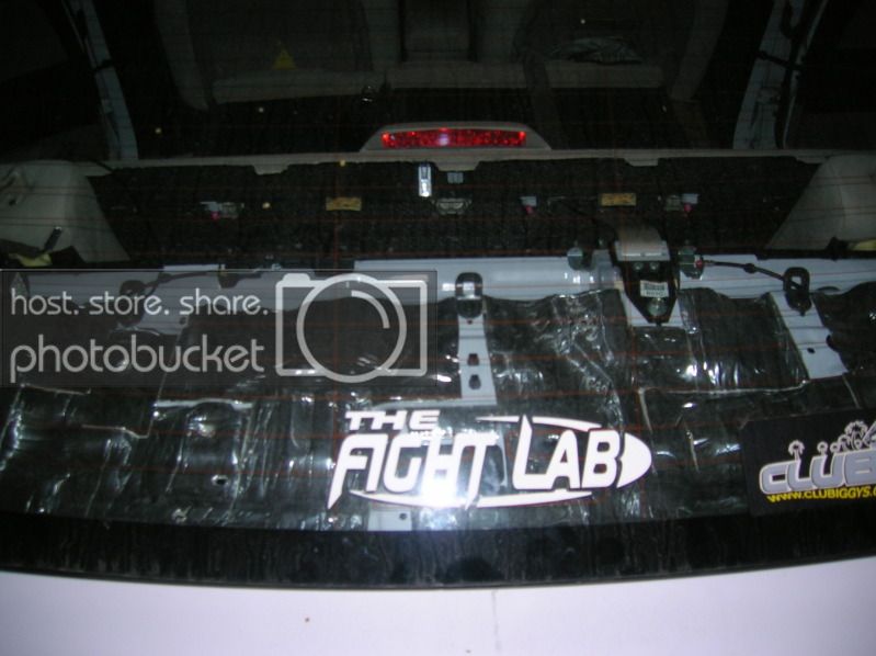

It went on easy and sticky, and the roller helped a lot. But it was also easy enough to press down with my fingers. It took maybe an hour to do the trunk lid, maybe a bit more. And the rear deck lid took a couple hours, though it'd probably go by much quicker if it wasn't my first time. And because it was my first time, please make any suggestions on something I should have deadened and missed, or any sort of tips! I'd really appreciate it. I've still got around 1/3 to a 1/4 of the roll left, so I can still tackle some areas that would be useful, if you guys suggest it. Here's some pics to fap to!
Year later update:
It's been a year now. Now in southern California we don't have to deal with humidity, or very low temperatures. But it did drop to the 20's over winter. And it's been 100+ since then in my trunk this summer. The AT is still holding on like new. It hasn't shifted or started to drip or goop or anything. It looks pristine. Just thinking about it today, I was shocked to realize it's been a full year.

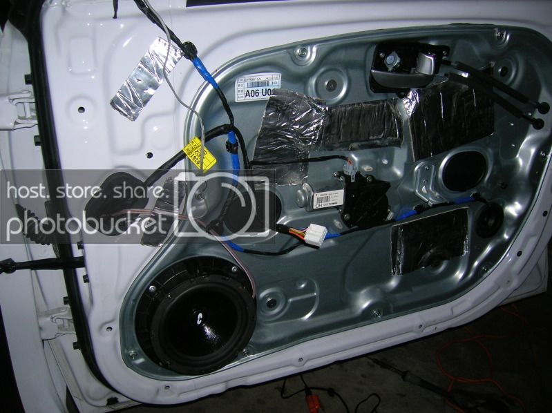

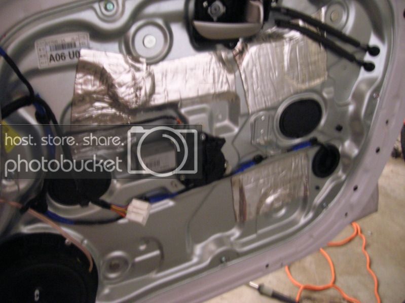

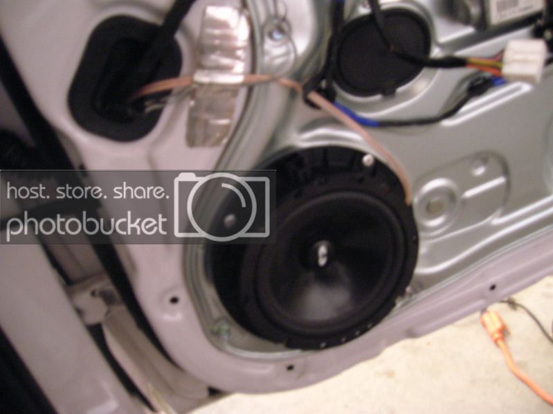

Absolutely. I didn't notice a ton in my doors, but I think that may be because they were already sealed up from the factory. But I could hear it when I shut them, and they feel more solid.
For the trunk lid and rear deck, it's a night and day difference.
This is the last bit I forgot to copy and paste from a year ago:
"And this stuff works great! My trunk is solid, you can hear it when you shut it and knock on it. No more license plate rattle And boy can I hear the difference when I drive. I was so pumped the first day, smiled my whole drive. It was like I got a whole new system, very exciting. Almost made up for my grossly undersized enclosure for my subs. It'll be really nice when I get the new sub and custom enclosure in I can't wait.
Also, it's been two very hot weeks here in California, and this stuff is holding GREAT! We've also had a few chilly nights with hot days and those temp changes aren't messing with it. So, I have absolutely ZERO complaints for this product. The only way it'd be better, would be if it was free:p "
I still hold that to be true. Definitely reduced the flex and vibration in my trunk. I wish I knew where my leftovers were so I could do the spare tire well and what not.
That said, only using about ~17ft of the roll and I got my trunk lid, rear deck, and front doors done. As long as you're going to be keeping your car for a couple years, I would never hesitate to recommend it, as a necessity.
