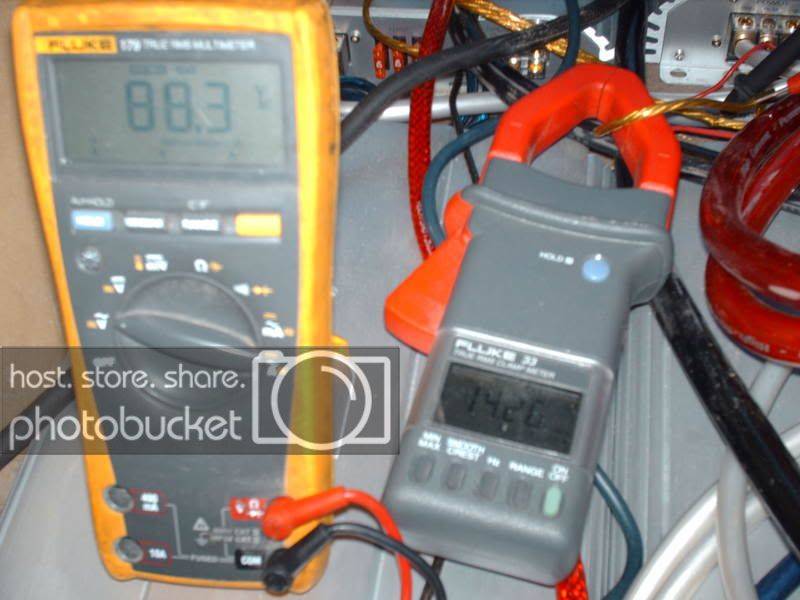

The box is 2.0 ft^3 net, tuned to 34 hz with a 6 inch aeroport. The tone played was 49hz. Actual measured power on the woofer was 2518 watts total.
I forgot to show the clamp and DMM while taking the video so I walked over and took a picture afterwards. This is the power from 2 of the 4 amps, so double the power, and that is what the woofer had running it. If you can't see the clamp meter clearly it says 14.26 amps.
I built this sub with the soundquality soft parts. It has a dual 2 copper coil and a little softer suspension then the 8 layer Aluminum FW sql version. The box is not ideal for the sub and is tuned a little lower then I like but I though it did pretty good considering J was playing a 49Hz note in a 34 Hz box.
