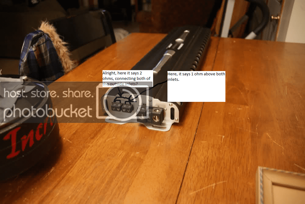

BFeezy 10+ year member Sneakerhead 1,000 1 NY Oct 21, 2011 #1 Alright, what I need to know is if I can wire a dual 1 ohm sub straight to this amp or if I need to wire it to 2 ohms and run it on a single channel Click to read more...

Phoenix Risen 10+ year member OG.... Original Ginger 4,160 103 Dayton/Springfield, Ohio Oct 21, 2011 #3 you could easily run each coil to one set of terminals. or you could just series the sub to 2 ohms and bridge the amp. which would probably be the best choice.

Phoenix Risen 10+ year member OG.... Original Ginger 4,160 103 Dayton/Springfield, Ohio Oct 21, 2011 #6 they are 3k at 2 ohm. 1500x2 at 1.
OP BFeezy 10+ year member Sneakerhead 1,000 1 NY Oct 21, 2011 Thread Starter #7 so if i want to run it at a 2 ohm load do i bridge it? or do i just run it on a single channel?
VWBobby 10+ year member PG and SS nuthugger 1,391 36 West coast Oct 21, 2011 #8 Bridge it by using the 2 outer speaker terminals. Wire your sub for 2 ohms and you'll be golden.
