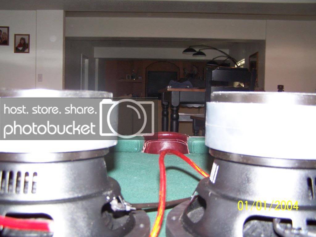

Knowing these subs were great drivers I purchased 10 more. Well about a week ago the first set arrived and low and behold they looked the exact same... BUT, I get to inspecting them more over and find that the motors on these sale subs are not even close in size. The bottom and top plate are within a 1/4" smaller than the older ones i have. The pole piece looks to be sleeved and the back plate is even milled for less steel. I will post pics.

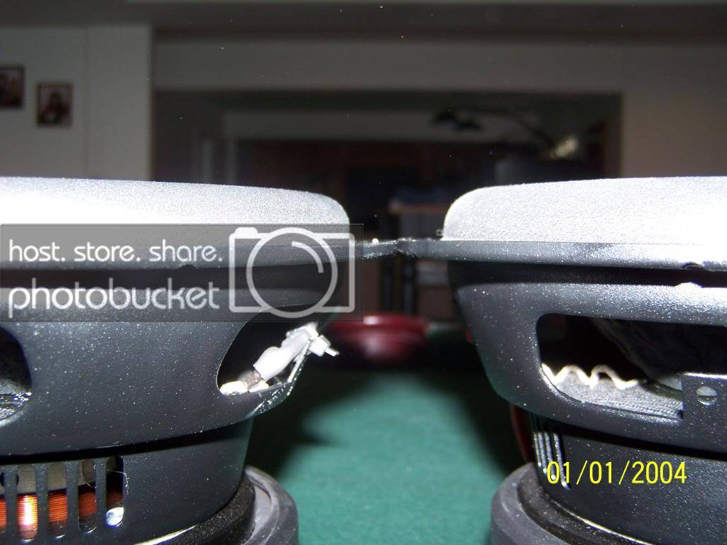

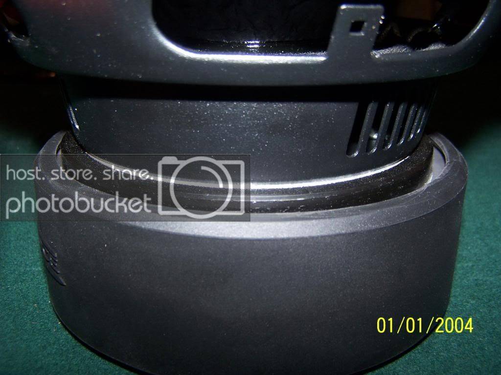

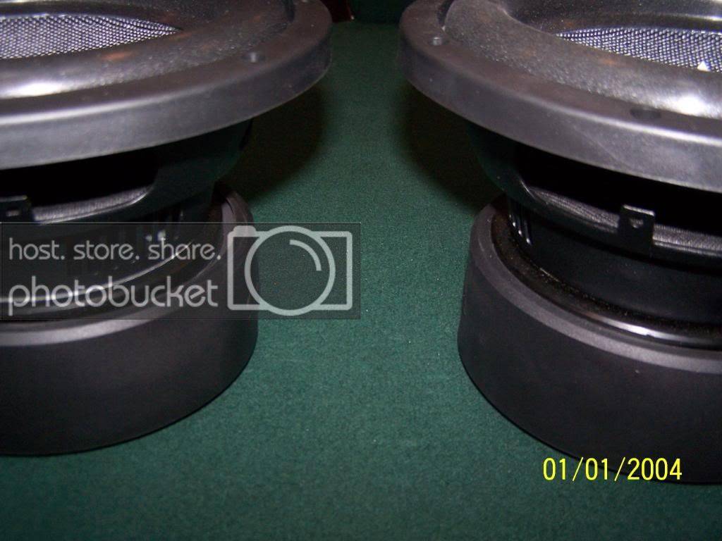

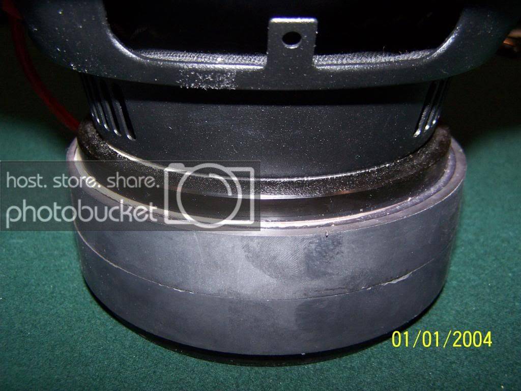

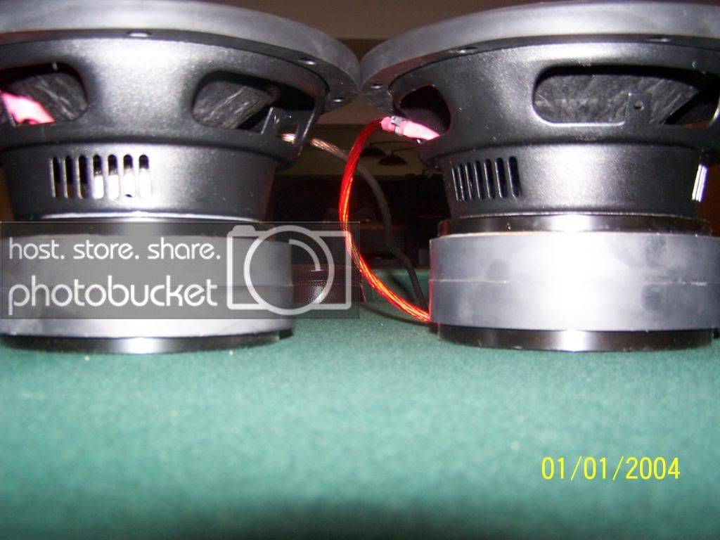

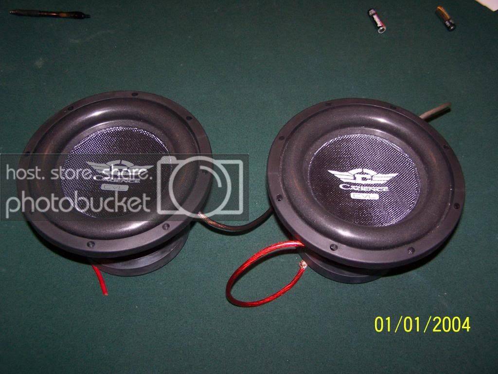

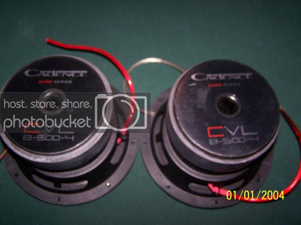

The older Gen 1 model is on the right in every pic New one from amazon is on the left. They are easy to tell apart as these new ones have a dark brown lead wire rather than silver

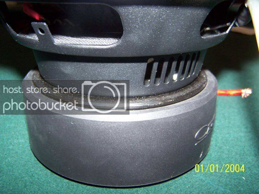

look at the top and bottom plates. different in height and width
newer one
older Gen1

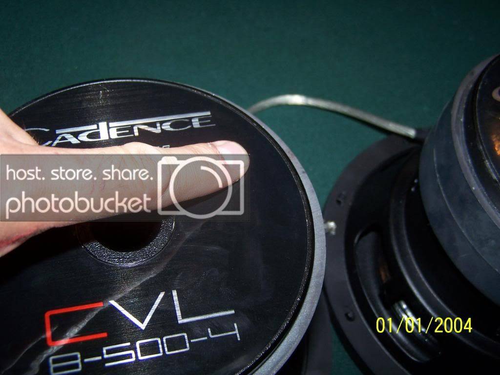

different thicknesses is visible here

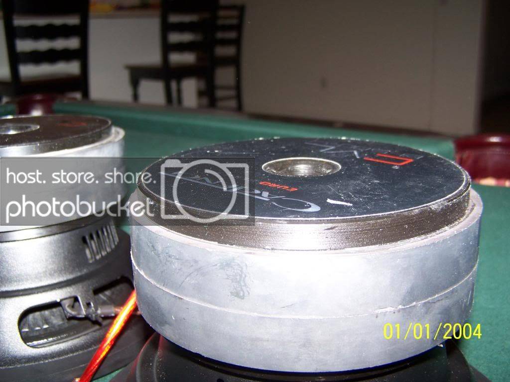

pole sleeve is visible on the new one here on the left
older Gen1
the milled edge where steel was taken out from newer model

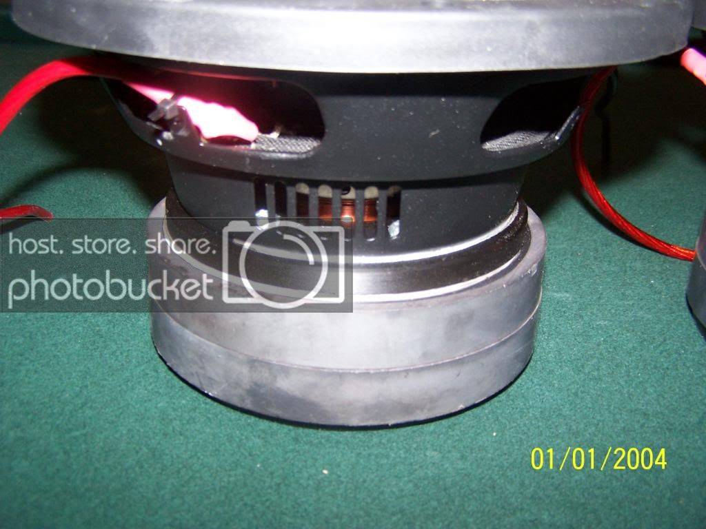

the older Gen1 magnet boot covers dont even fit the newer ones (newer left/Gen1 right)
newer
older Gen1

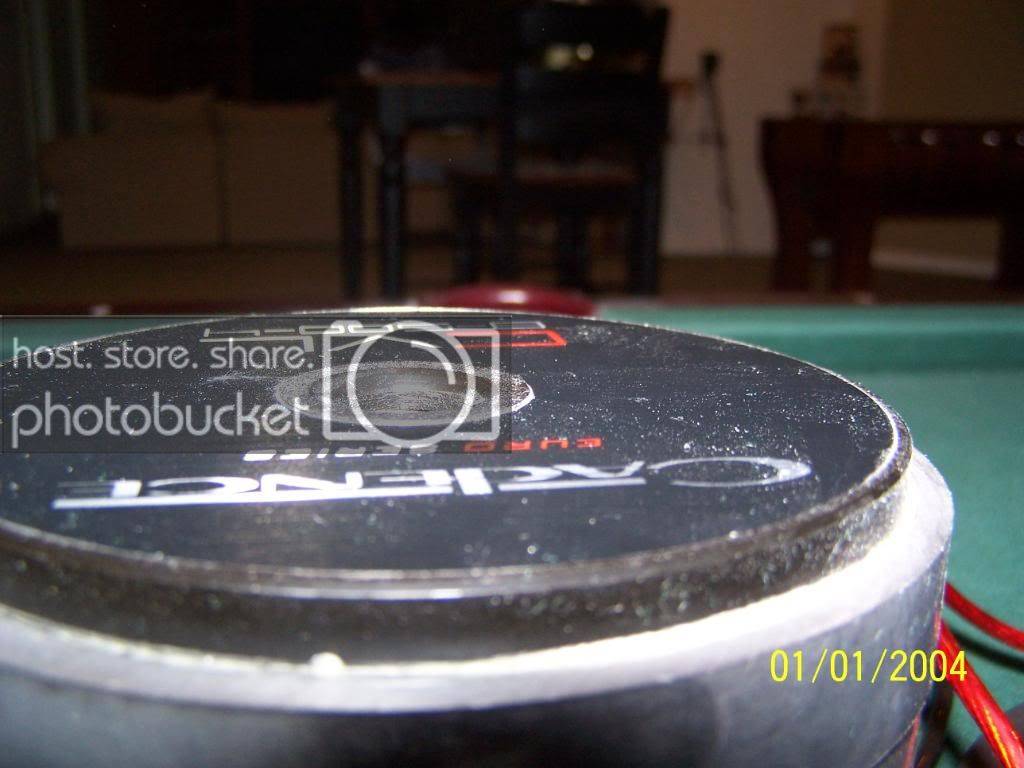

the newer ones are millimeters shorter even
