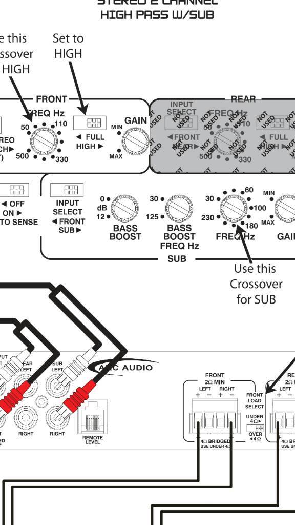

OK little confused first time I ha e seen an amp with these settings. I know what the bass boost is but to the right of it it has another bass boost frequency setting. What exactly does that do. Starts at 30 and goes up. Do I try to match that with the lpf is set at?
Sent from my SAMSUNG-SM-N910A using Tapatalk
The FREQ Hz is the overall sub crossover. I'd set it around 80hz. On this amp, I would set it at the 2 O'clock position to get 80hz.
I would leave the Bass Boost at 0.
The bass boost FREQ Hz is where you want the bass boost to boost the frequencies.
I woulnd't mess with it. No need for bass boost at all
Yes. I have the lpf at 80. Odb for the boost and 30(lowest setting) for frequency boost. First time I e run across that,setting and was curious. Not a big fan of boosting. Thanks for the advice and clarification.
