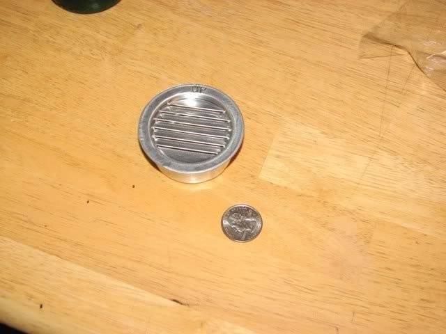

the aperiodic mat is usually sandwiched fiberglass or open cell foam. the thickness vs. area determines tuning. you can tune the Q of the enclosure with the vent. you can also control the fs impedance spike.
pics of your colander? are you saying this is outside the car protecting the speaker?

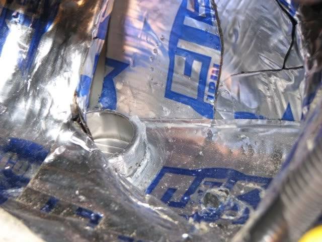

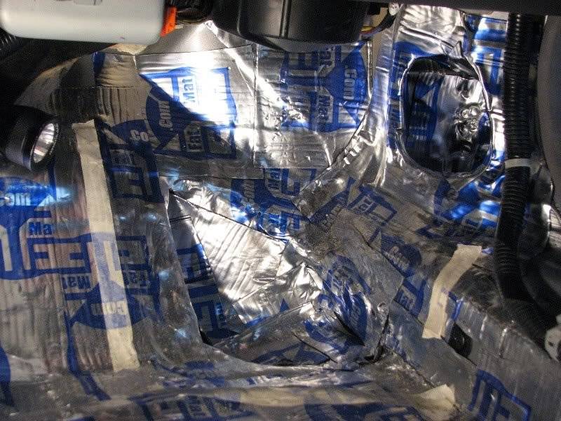

BXT II on the baffles. I also added 1.5lbs of non-hardening modeling clay inside the midbass cavity - in the nooks and crannies, along the baffle inside seams, etc. I also put in a ribbed rubber mat to mimic a deflex pad.
Then I did the passenger side as well, new deadening, another 1.5lbs of modeling clay, rubber mat, etc.
new baffle is same as previous. i designed these baffles to be removable and swappable - good thing. //content.invisioncic.com/y282845/emoticons/smile.gif.1ebc41e1811405b213edfc4622c41e27.gif

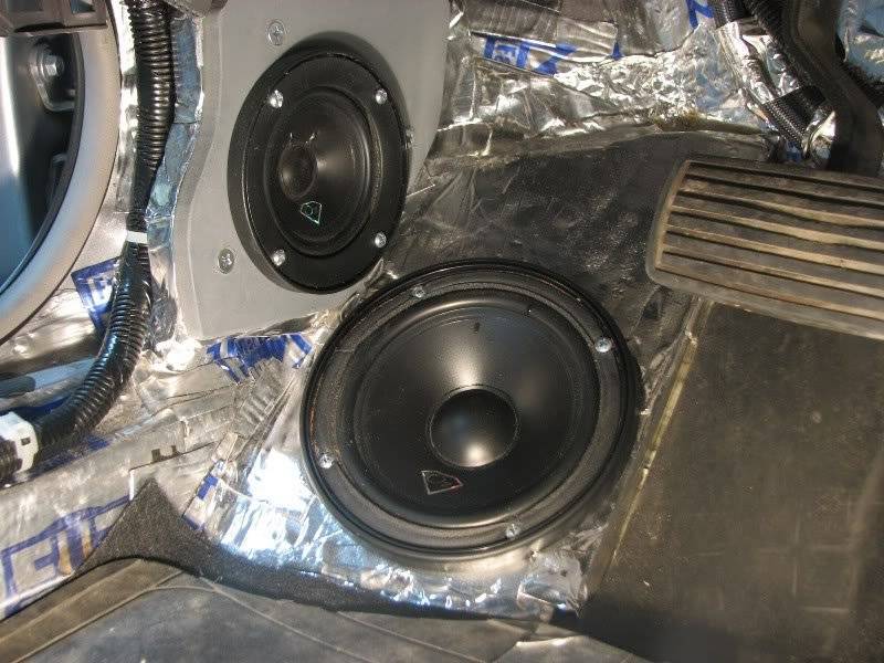

Keep_Hope_Alive,
Very nice install!! I bet your stage sounds perfect. Nice placement and aiming of the speakers. Only thing I would be worried about is stepping on them, other than that, very cool. //content.invisioncic.com/y282845/emoticons/smile.gif.1ebc41e1811405b213edfc4622c41e27.gif
i have grills to protect them and carpet over that. they've also handled two winters (in northwest IL) with ease. yes, the soundstage is very good with a little T/A.
i want to recarpet the floors so they are completely stealth. since they don't take up any floor space, people don't see them.
