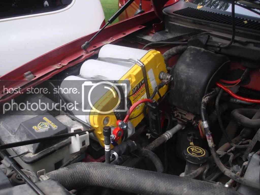

A custom battery install really isn't that tough. With a little work, you can fit a pretty huge battery in a stock location, like this Optima D31T that I fit under the hood of my F-150. I didn't cut anything or make any big changes. It only took about an hour.
I'm glad you found what you were looking for, but it just sounds like you're looking for solutions that you want to hear, not ones that actually work. If you want to give your amps more "juice," you're going to have to do electrical work, not give your charging system another load.

^^^That's sweet. I used to run a D31A in the trunk of my Caprice with a red top up front. I gave up on that because my rear end was sitting funny because that thing weighs like 60 something pounds. //content.invisioncic.com/y282845/emoticons/crap.gif.7f4dd41e3e9b23fbd170a1ee6f65cecc.gif I'm sure the shocks on your truck are much stiffer and not nearly as affected as my Caprice's *** was. I'm running a D34/78 up front (bigger than the factory battery) with a big 3 done with 1/0 AWG. I can't tell any difference in voltage from when I had my D31A in the trunk.
