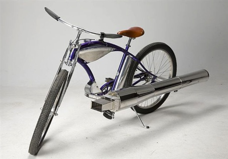

I just picked up a panterra baja 50 bike to add to my collection for free from a friend, just like the one pictured here. The top end is toasted and ive torn it completely down, everything is good other than the piston and cylinder, both are completely trashed. I had a spare 110 top end laying around, so i put the 110 cylinder and piston on and everything fits fine, but the cam chain is too short due to the 110 cylinder being about 1/4 inch taller than the 48cc cylinder. What can i do to make the 110 top end setup fit on this? I definetly dont wanna rebuild it to a 50cc if i dont have to, i have another 50 and its slow as piss. I can get the 110 cylinder machined down if need be, or what are my other options? Also if anyone has a 50 top end for cheap though id consider buying it.
