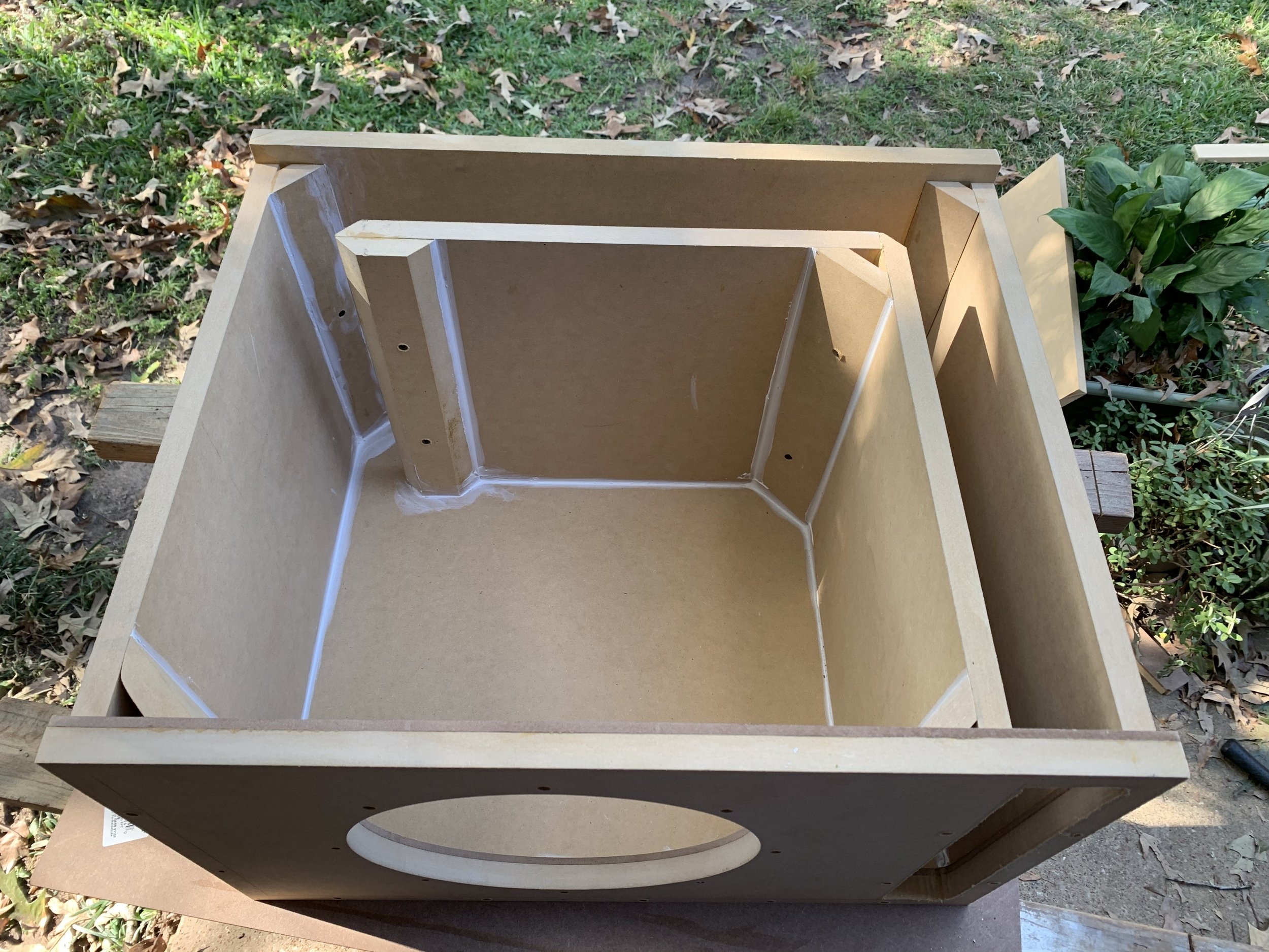

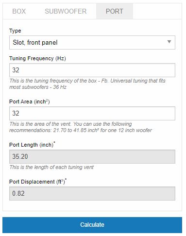

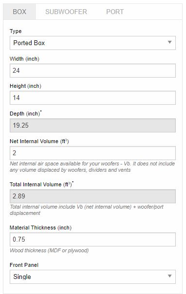

Here’s what I’m looking at building. Let me know if I’m close or way off, please.
