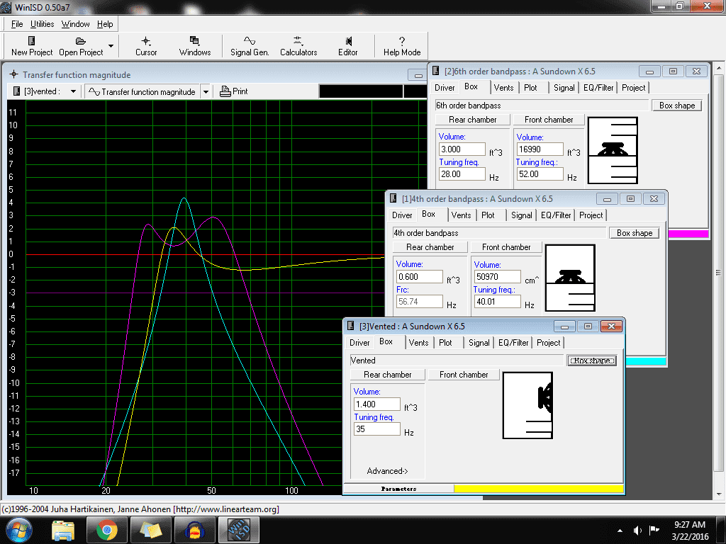

anybody willing to model a 4th order with 4 Sundown x 6.5's?
Jroo
Yes, I am looking at 4th order. It will port through the ski pass in my Volvo. I am looking at 4 of the x 6.5s and looking for more of flat response. Trying to get it to play roughly 70 down so I think that would mean a higher tuning on the 4th and possible closer ratios since I want it to play flatter. I am being told that 1:1 or 1:1.5 would give me the flat response but might not give me a lot of gain, so I am open to ratios. Also hearing that 1 cube common chamber sealed for x 6.5s is a good place to start and will give me a good amount of low end out of them.
Anybody willing to help me out?
6th order with 4 might be a bit over my head. For giggles, what does the box model like in 6th order for 4 of these?
6th order rolls off at 26hz down low and rolls off 60hz up top with a dip in the mid 30s
4th order 35-45hz
ported 32-47hz tuned to 35hz
34hz to 53hz tuned to 38hz
Will WINISD allow you to model a 6th like this?
You guys read my mind. A 6th order just like this would be the way to go. Tune it all low and sacrifice a bit of the top end of the passband, then just hand off to a strong midbass.
Would be awesome.
