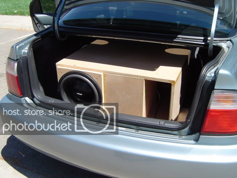

this is my spl box: 4ft^3 net tuned to 47hz. i cut the wrong circle for the sub so you can see that extra baffle:D port area is 75sq inches hoping to see some #s this sunday:)

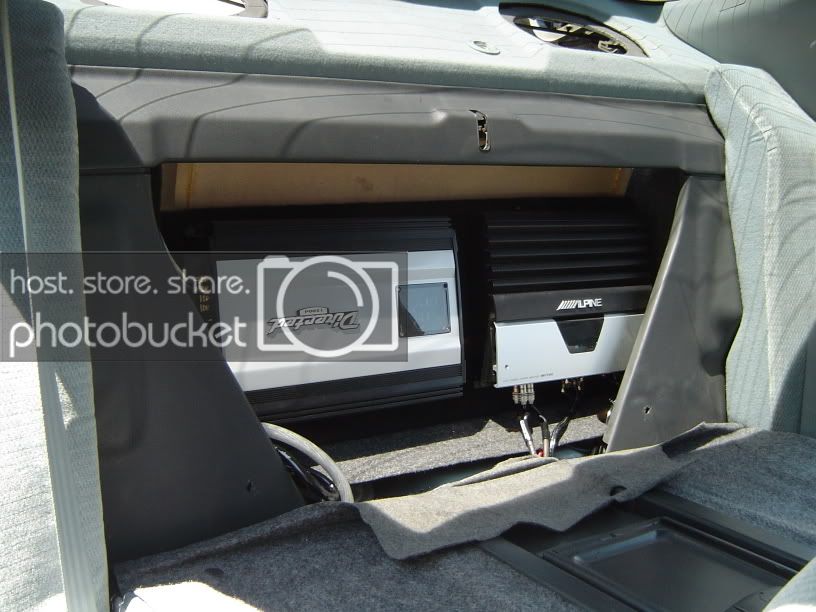

the box will be turn 180 degrees facing the cabin when metering and amps wil relocate to the side, too much work

its aiite, im thinkin bout getting abother 1500d
its getting cooler now when its mounted like this and windows down. it was warmer before when i had them down, dont know why though.

hehehe, thats not how i build my boxes, just to begin with. now i gotta go find my loudest note. it seems like to me that i need to arrange my amps to the side of the box so i can get more air into the cabin
