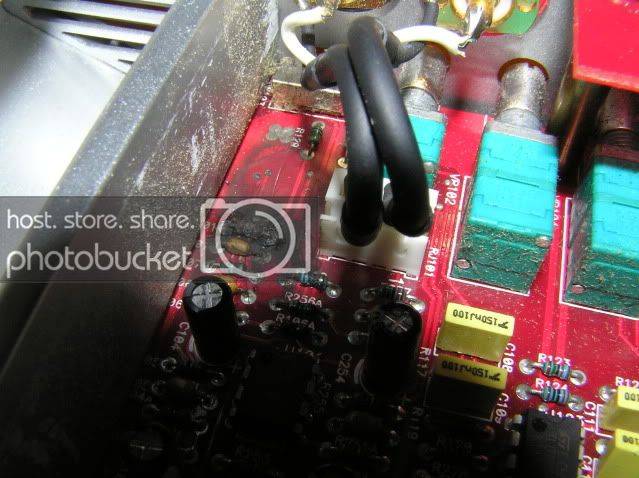

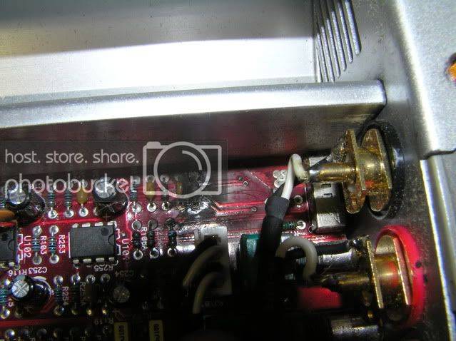

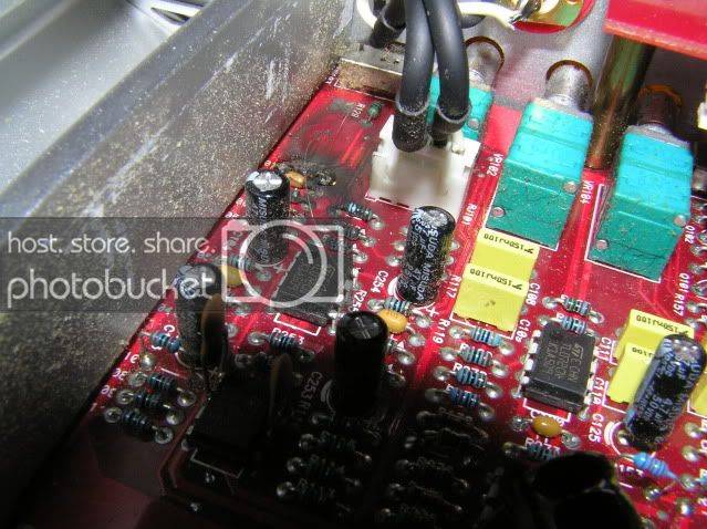

I opened the amp again and sure enough, 2 resistors are burnt out. They look like they are leading to the input sensitivity switch and/or gain.
Anyone have an idea on how much this may cost to fix? I will put a pic up in a minute.
Alright, thanks for the responses.I opened the amp again and sure enough, 2 resistors are burnt out. They look like they are leading to the input sensitivity switch and/or gain.
Contact dB-r. He's good for it.
That's pretty bad. Not sure if you got some blown small caps or if those were resistors...
Sometimes when the + battery or remote terminal + touches the shield (outside part) of the RCA connectors it will smoke some resistors in the amp. This may be what had happened when it "fell". PM Makeshiftaudio and see what he says, or email AudioRX@cox.net As in your PM you know I cannot take it in right now.
